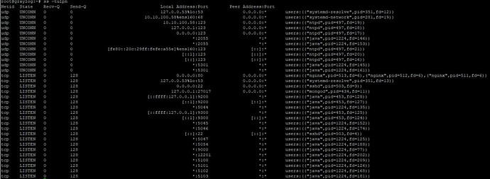

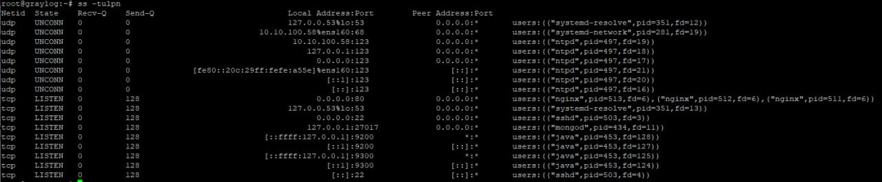

This is the situation before contant pack install, using the command ss-tulpn
Than I install the content pack but an input failed to start
no other input with the same port
using the command ss-tulpn we see the port used
And I a restart Graylog wothout change any port number sometimes (2 or 3 times) it start correctly.
