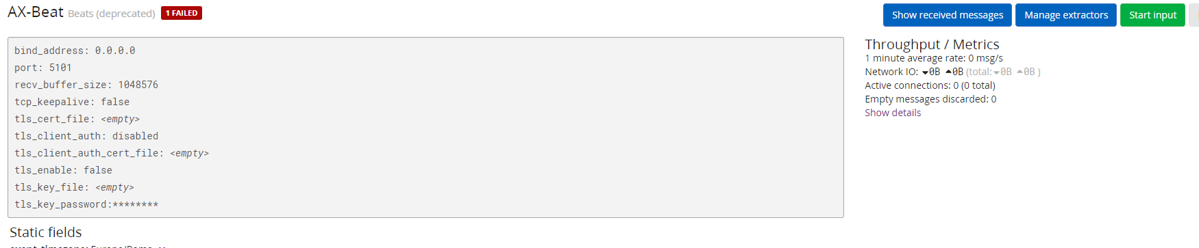

Then I create and install my content-pack (without parameters but with required inputs)
Content pack is uploaded with success but looking the input I see
running ss -tulpn
When I try to start the input I have and error:
where the log say
2021-05-19T13:04:51.627Z WARN [AbstractTcpTransport] Failed to start channel for input BeatsInput{title=AX-Beat, type=org.graylog.plugins.beats.BeatsInput, nodeId=null}
io.netty.channel.unix.Errors$NativeIoException: bind(…) failed: Address already in use
2021-05-19T13:04:51.627Z ERROR [InputLauncher] The [org.graylog.plugins.beats.BeatsInput] input with ID <60a50c20a010fd30e2204d1a> misfired. Reason: bind(…) failed: Address already in use.

2021-05-19T13:04:51.631Z INFO [InputStateListener] Input [Beats (deprecated)/60a50c20a010fd30e2204d1a] is now FAILED
At the end the strange, very strange, situation is that is I restart Graylog, I don’t have input error anymore
That’s strange behaviour, because you have no input but ports are still listening. I think thats the problem, why are input not started after import.
