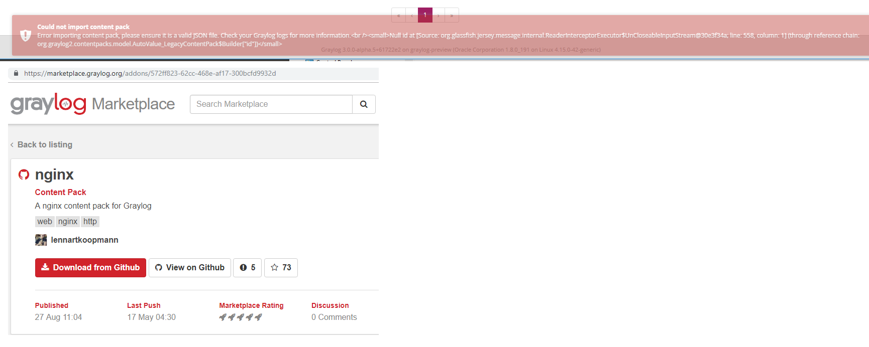

  1. Most popular “nginx Content Pack” could not be imported

  3. If you check nginx in marketplace, you can go to the github page, where a big notice about the content pack is deprecated. Also another content pack’s link.
    https://github.com/graylog-labs/graylog-contentpack-nginx
    The content pack was written when GL 3.0 was not available, so maybe it is normal if you can’t import a pack what not compatible with the new version.

  3. Not a big issue, will be waiting for update compatible with v3.0

For the Contentpack - did you read the changes of 3.0? Content Packs are reworked and old content packs are not compatible anymore. That is done on purpose.
