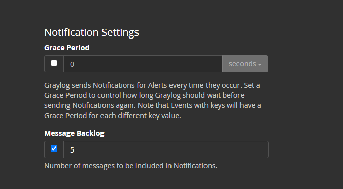

Have you tried something like this instead.

Thanks!!!, what you suggested about disabling the Grace Period and just defining the Message Backlog worked!. I get emails with the backlog messages details I needed.
