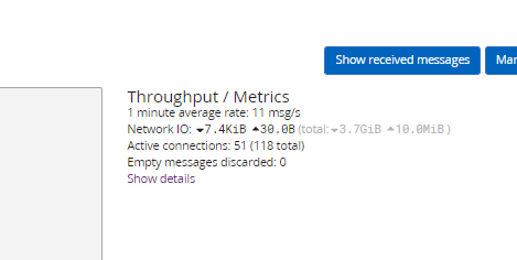

It’s not clear if you are seeing the data pass through the Graylog at all - When you look at the Inputs are you seeing data come in? Should look something like this where your average rate should be above zero.
If you aren’t seeing anything there, check to make sure you updated server has retained the correct network address, and any firewall you might have running (such as UFW) is allowing data in.
If it is getting to Graylog but not getting pushed back out to be stored in Elasticsearch then your buffers will start to fill in System/nodes and node detail.
