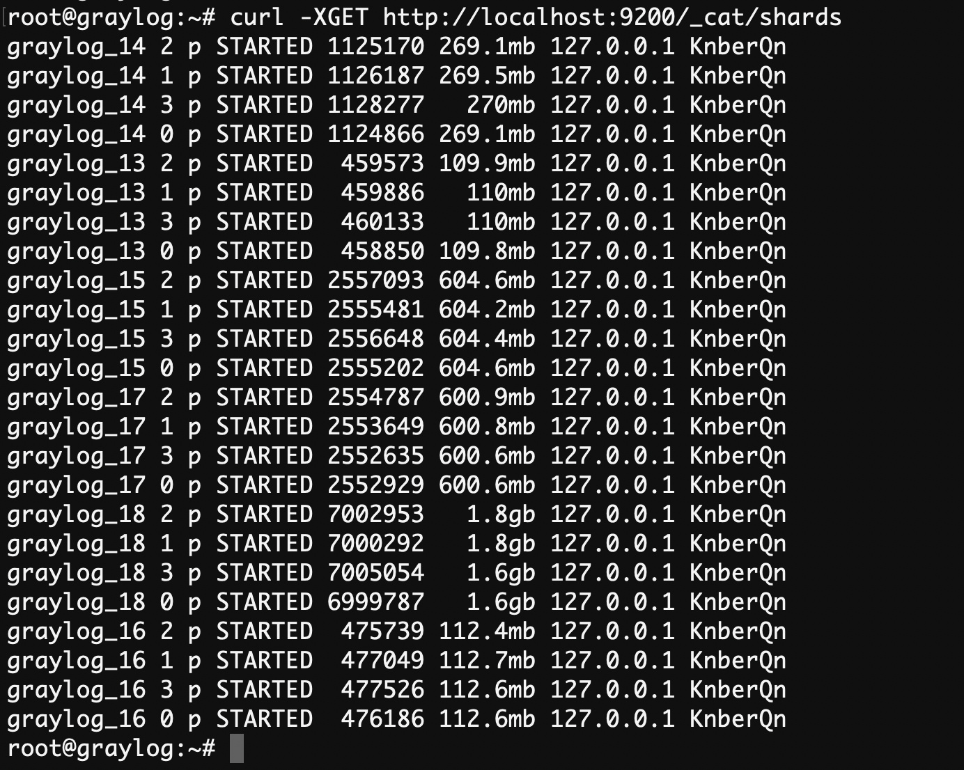

This is very interesting for me. I am not able to search for anything on graylog. On screen it shows batchjob_logs_195 is not found but the main thing is that I don’t have any index of same name on the elasticsearch. I have taken mongo collection from another graylog server and dump this on present graylog. Also, I deleted everything but still it shows old indices.
All the shards are green.
