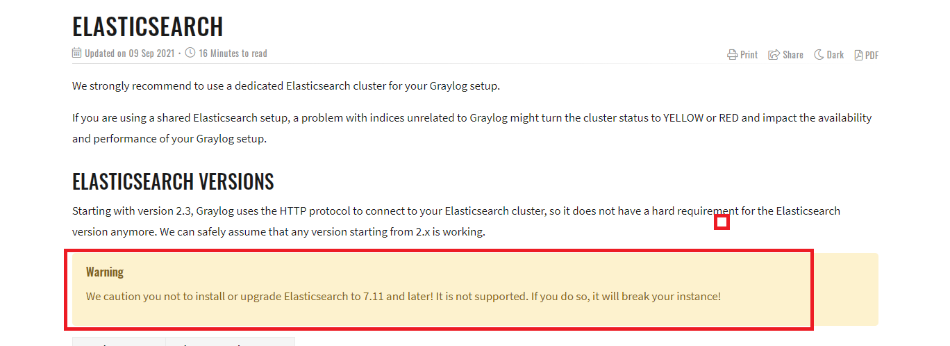

First thing I noticed was this.
Have you seen this?

Hi @gsmith,
Thanks for the note about the Elasticsearch version. I hadn’t seen that.
This is an older instance, and I upgraded from ES6 to 7 months ago. I didn’t go back and read the new install doc page, but I see that’s where the screenshot is from. Interestingly the upgrade page in the docs, doesn’t mention the ES version.
