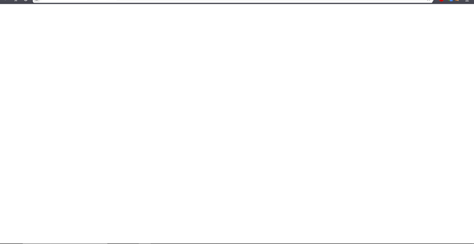

after update i have this
if i writing curl localhost i getting this:
but if i add port 9000 i getting this:
I think this is because of nginx. I have a redirect from port 9000 to port 80 and ssl connection using nginx
Yes i use curl https://ip-addr.graylog.com and curl return me this
but if i use http prtocole curl returne me 301 error.
without knowing what you have configured nobody is able to help you - because google is your friend about http returncodes and their meaning …
Is solved. I forgot change revers proxy for graylog v3. But now i have same problems.
