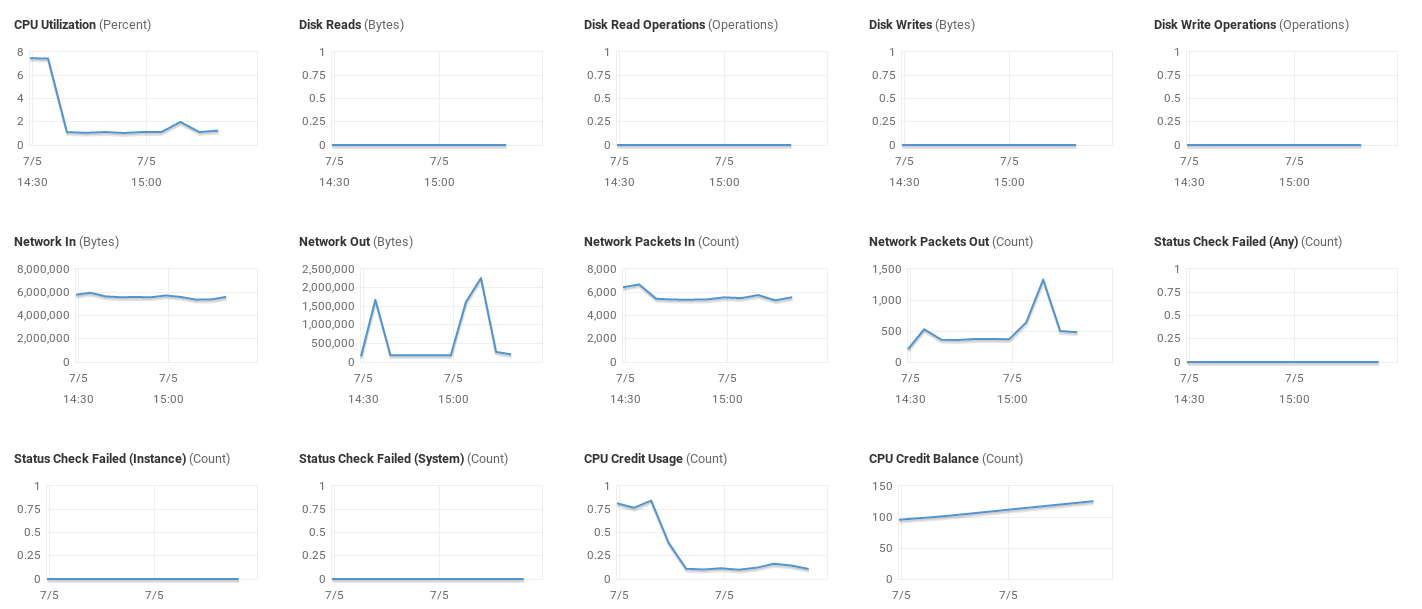

Thanks Jan - I’ve been monitoring the same over previous failures and haven’t seen anything that sticks out, except one itching thing in the graylog server log file (will attach at the end).
I see nothing consistent with overload in system metrics, but do see the network traffic still trying to come in (but graylog doesn’t appear to listen):

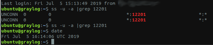

I suspect it is possible the following issue is related to mine, I will investigate:
By this ticket, it appears that the UDP receive can be trashed by malformed packets (bad validation?)
I will use ss next time this happens to see if the listener is in fact dead or alive. If dead I will see if I can reproduce the other issue’s OP’s solution - more to come.
Update: Indeed, you can see below that initially the listener is present, then is gone after the logging stops functioning some time later:
I’ve also noticed that since I increased the number of incoming Apache logs (more servers) the fault happens more frequently (every hour or two so far).
