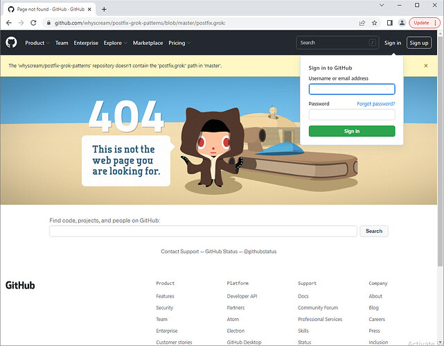

First, the link you posted.
Second [total_delay] field can be corrected by setting the index template to a integer or what ever is needed.
Hi Folks,
That´s the Link he Posted for the Grok Pattern he is using: postfix-grok-patterns/postfix.grok at master · whyscream/postfix-grok-patterns · GitHub
