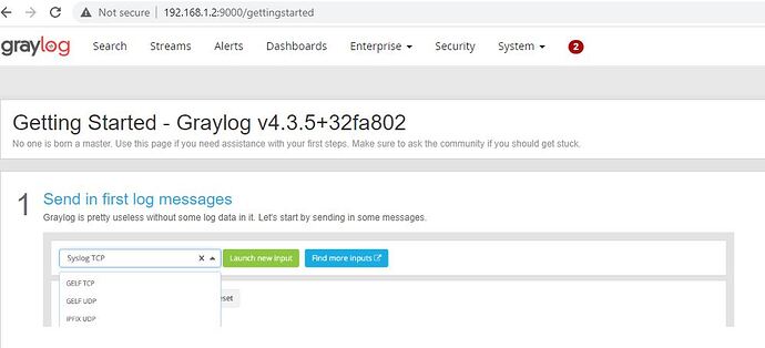

EDIT: But this thing is, you should still be able to login Graylog Without Elasticsearch, so I would double check for duplicate configurations, Permissions on files and folders, firewall and/or check Selinux/Apparmor enabled
I have deleted the duplicated lines in ElasticSearch config file and corercted the IP address to localhost 127.0.0.1 , and now I can access the Graylog WebUI thru http://IP_Address:9000
FYI here is the output of cat command for elasticsearch,yml file:
ubuntu@ubuntu:/etc/selinux$ cat /etc/elasticsearch/elasticsearch.yml    | egrep -v "^\s*(#|$)"

hi there,
It seems that ElasticSearch is not ok.
ubuntu@ubuntu:~$ curl -X GET http://192.168.1.2:9200/_cluster/health?pretty
curl: (7) Failed to connect to 192.168.1.2 port 9200: Connection refused
You were able to see elasticsearch via loopback (127.0.0.1) so put loopback in your cluster check…
ubuntu@ubuntu:~$ curl -X GET http://127.0.0.1:9200/_cluster/health?pretty
Yes, with 127.0.0.1 the output shows Green status.
Then I suppose all is running
Thanks,
Enrique
