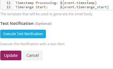

NOTE: We have the test Notification button back Awesome :smile:

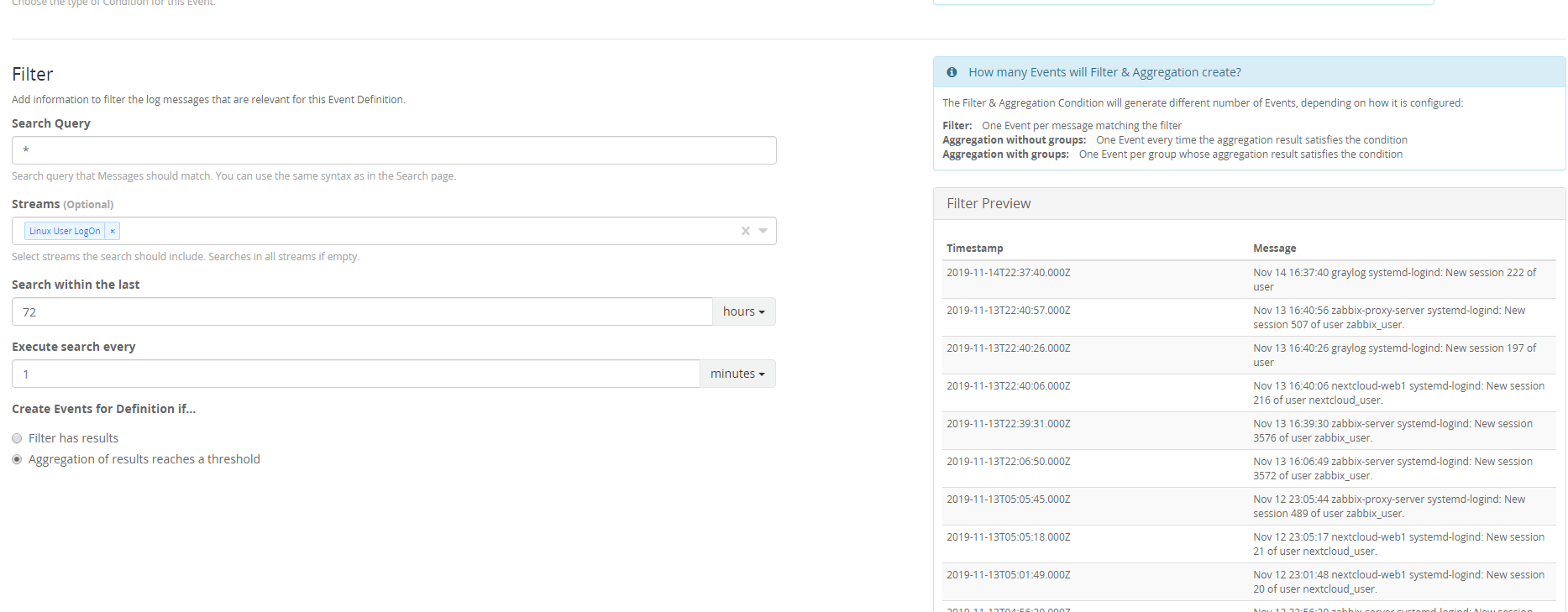

I’m not sure if this is related to my Views but when I configure Event Definition I only see one message. I wanted to see the past 3 days of message in Filter & Aggregation section. My Alert did not go off for that stream either. I set it for equal or greater than 11 count >= 11 messages.
I did a query for All message on the stream “Veeam License Expiring” but only shows one in Filter Preview when I should at least have 5-11 messages shown.
But if I select a different stream that did not have a pipeline on or attached to it like “Linux user Logon” stream I recieve the correct amount messages not just one.
