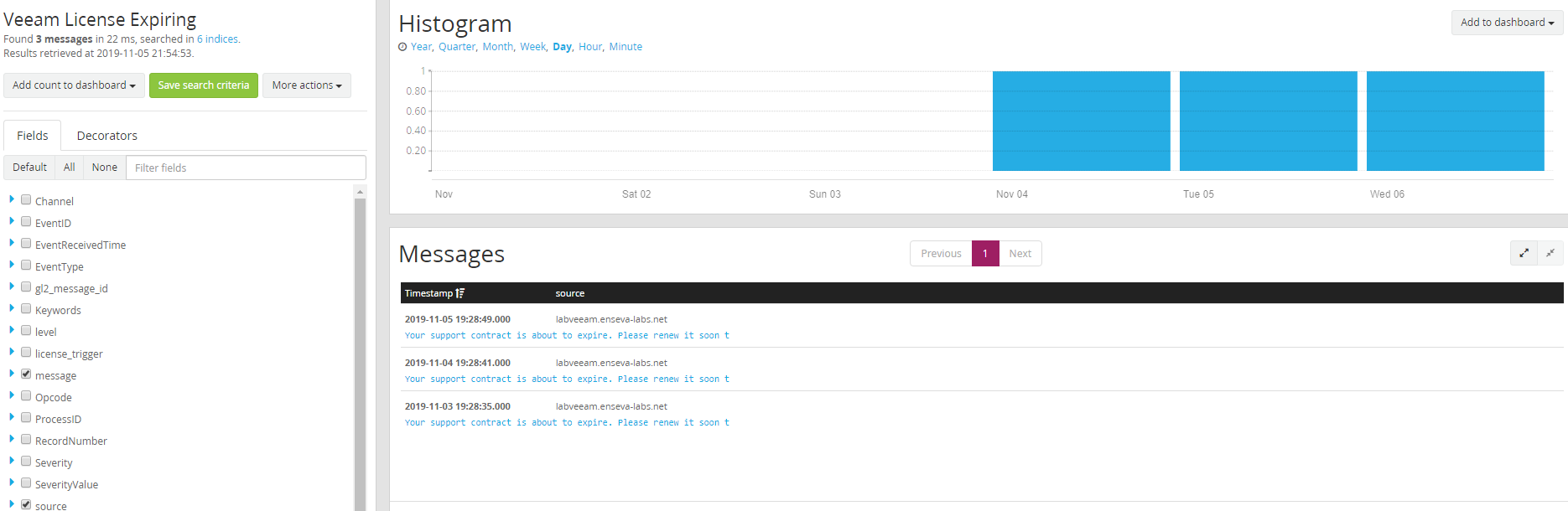

I made a stream called “Veeam: License Is Expiring” with a Rule Field EventID must match exactly 24040

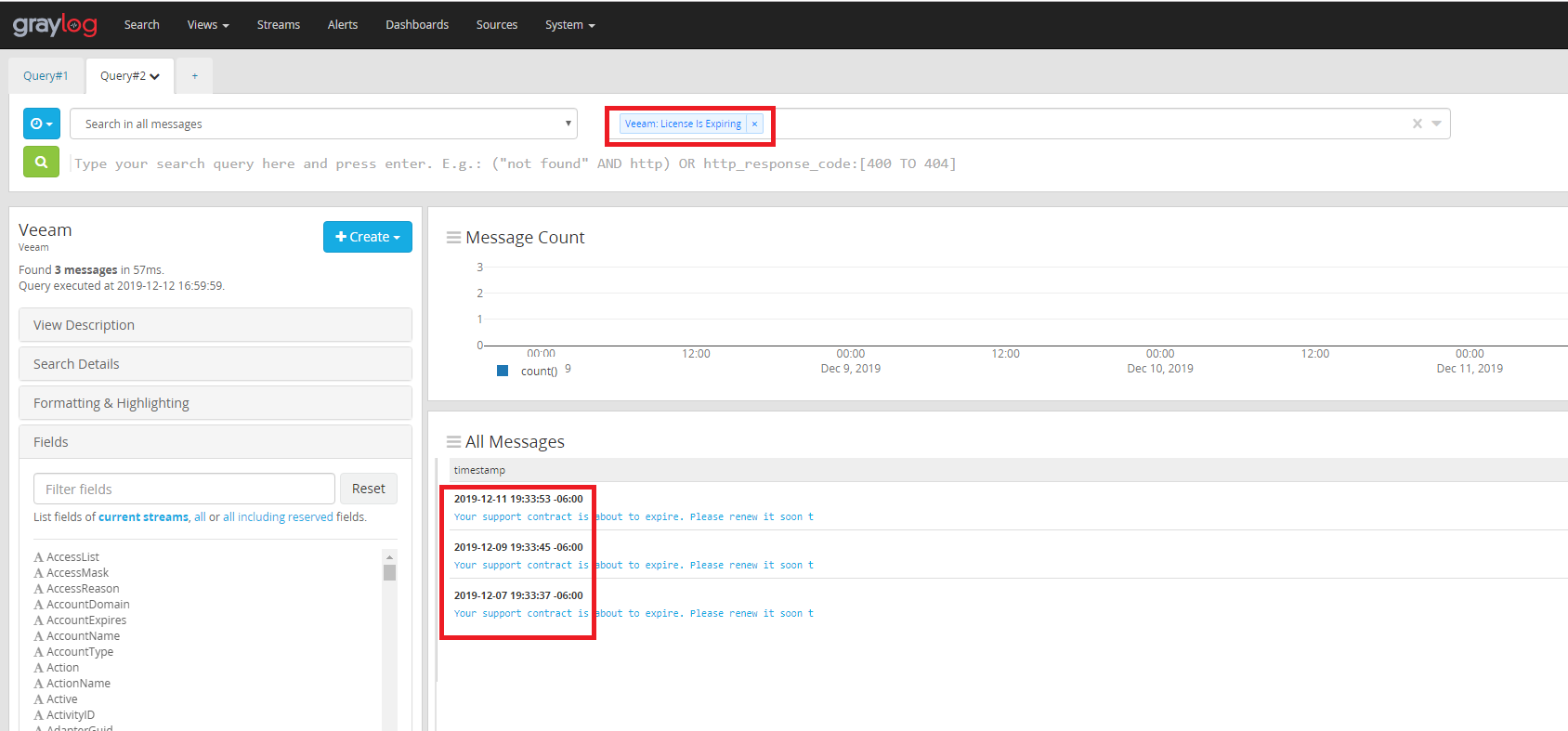

Then I created Extended search in Views called “Veeam”.
The first query I’m using “Search in all messages “, streams:5dcde5ac83d72ee2df7789b1
The second query I’m using “Search in all messages “, using the stream drop down “Veeam: License Is Expiring”.
As shown below the first query shows all my messages in that stream.
The second query is skipping messages as you can see by the dates
And this is the stream i’ve created
Before when I used the stream in Views it would only show 1 message, even thou I would search for All Messages. Now it seems like it only shows Odd dates and maybe be skipping some messages.
Any advice, Ideas or direction would be appreciated.

in the next release your bug will be fixed:
We already found it and fixed the issue.
@jan
Thank you so much. I was going insane, thinking i did something wrong.
