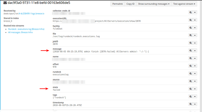

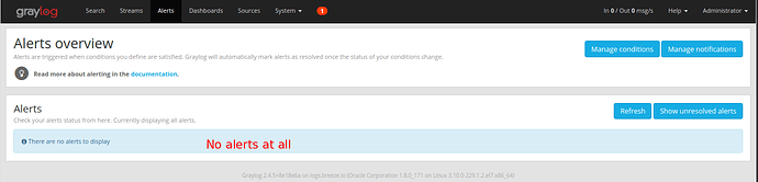

Even when this condition satisfies, there is no alerts shown in the alerts section, therefore, neither I am getting any alerts on email. Please help/suggest, what can I do to solve/debug this problem? Example image is as shown below:
Message is like shown in the image below:

Actually, the flow of message is like:
Beats add a field called “rundeck” with value “executionslog” to the message.
Based on this field value, the message goes into the stream (let’s say “Runceck : Executions Log”).
This stream is connected to the pipeline, which extracts and set a field “state” with value either “failed” or “succeed” based on message content.
In the Alerts section, I have created a condition (Field content Alert Condition) on this stream (Rundeck : Executions Log). As per the definition of the condition, an alert should be generated/registered, but it is not happening.
I have tried testing it with different fields and their values satisfying alert condition but getting no alert at all.

alert_check_interval was set as 1 second earlier. Now, I set it to 30 seconds and the Alerts for Field Content are registering now.
Earlier, even with alert_check_interval = 1, Message Count Alert Condition was working fine.
Can you please brief, Why Field Content Alert Condition was not working with alert_check_interval = 1?
Alerts are automated searches and with the check interval set to 1 second the search is done every second - if the search does not return before the next run the status will be overwritten and it never returns with a result.
It is save with running every 60 seconds - the default - shorter times might behave different.
