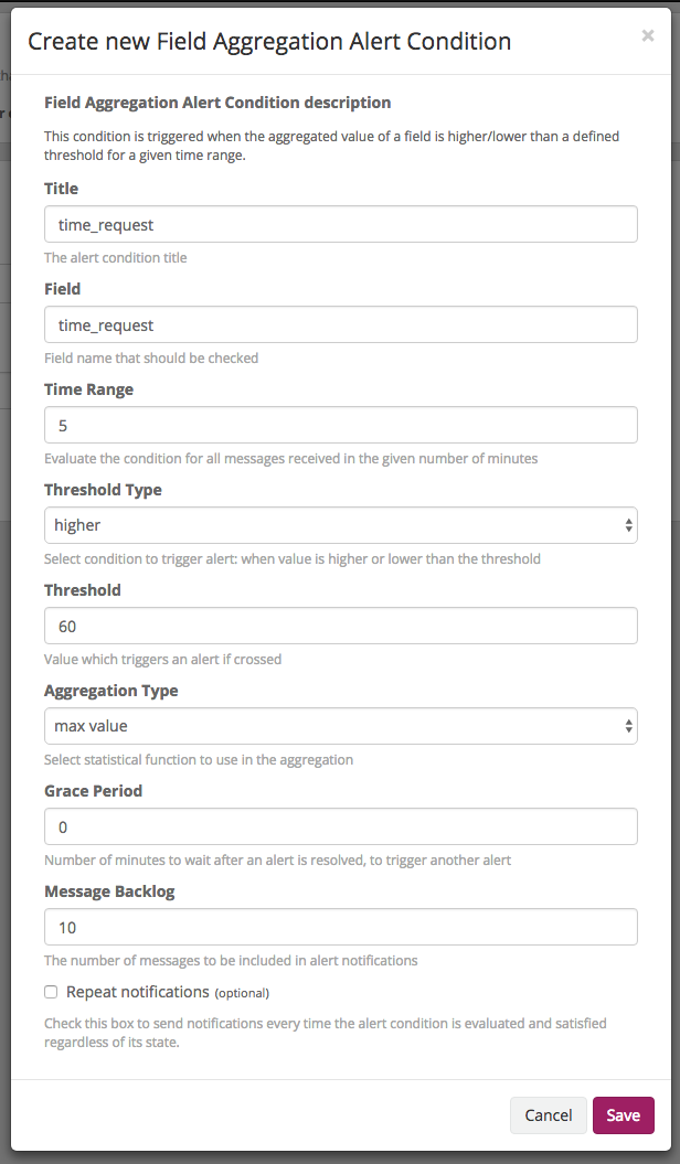

You could probably build a Field Aggregation Alert condition which checks the maximum value of the “time_request” field over a given time range:

Hello Jochen,
great, it works!
