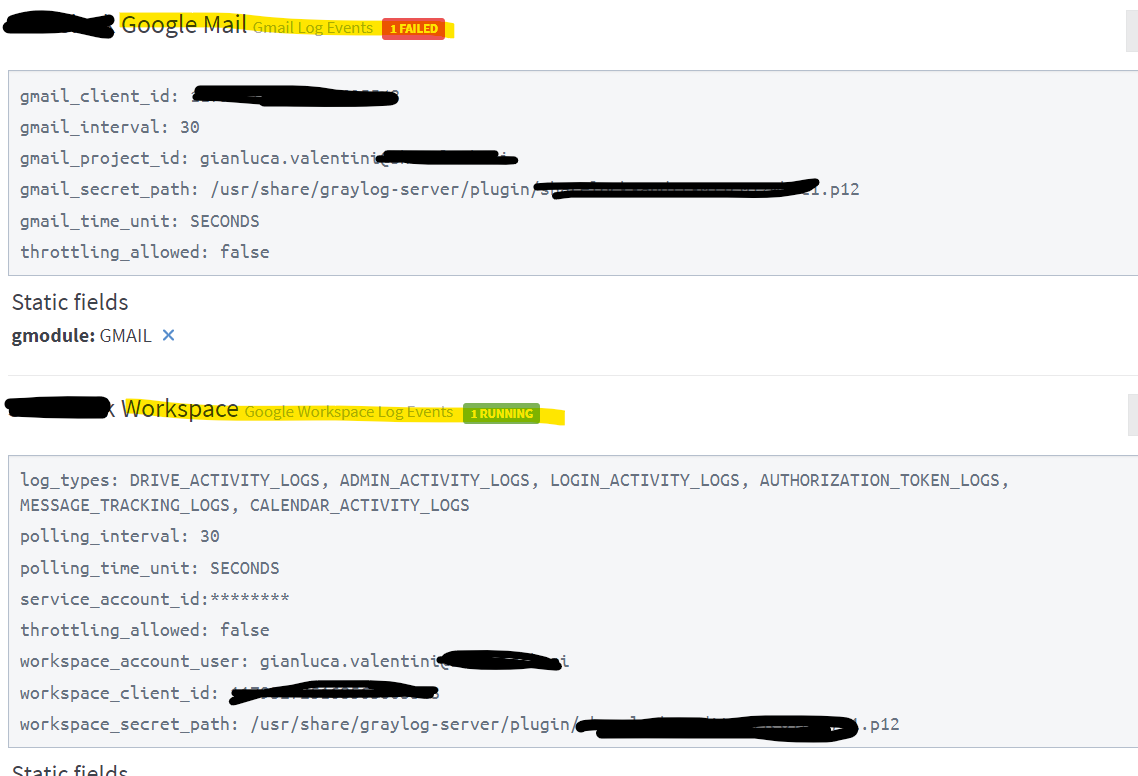

I finally installed and started graylog 5 enterprice with free license (small business).
Configuring Google Workspace input now I can ingest the audit log.
Now I need to read the Gmail log too. I follow the documentation here, but no messages are incoming…
I see some differences from input field name from documentation and Graylog input
For example in documentation I see:
Project ID Alpha-numeric project ID for the Google Cloud project
but in the input there is
Gmail Account User Email
Considering the wrong references to P12 I think that there is something that I wrong in the input configuration.
Can you help me to understand what I shoud set in the input Gmail Account User Mail?
Thanks
Gianluca

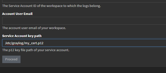

Hey @gianluca-valentini
I havent played with that yet, but do you see any warn/errors in the Log files by chance?
In your Google Cloud did you create P12 key? If so then copy that over to Graylog, for testing place it in Graylog Directory /etc/graylog/my_cert.p12
Then use that path in the input see if that works.
Adding on:
This would be the Team account for the company or user account. This is also where you make the Key for the input on Graylog.
https://go2docs.graylog.org/5-0/getting_in_log_data/google_input.html
Hi @gsmith
thanks a lot for your answer. I followed the instructions linked in the documentation.
I will test the p12 too.
The problem is that the Gmail input configuration that we can read in the documentation talks about service account json.
Let me test it. May be I will follow the descriptions present in the graylog input instead.
Thanks
Gianluca
Hi @gsmith
if i use the p12 file the Gmail input does not start while the Workspace one (that use the same p12) is working fine
I’m confused now
Hey,
Can graylog access it? Check permissions on the certs, also what does it show in the log/s?
Hi,
Graylog can access it. The other input with the same p12 works fine (Google Workspace input)
If I set the p12 file, as described in the input documentation I have the follow error:
2023-03-10T16:16:29.481+01:00 ERROR [GmailTransport] Gmail Client count not be acquired. []
2023-03-10T16:16:29.481+01:00 ERROR [InputLauncher] The [org.graylog.enterprise.integrations.gmail.GmailInput] input with ID <63ff3996760dcc79b767fbbc> misfired. Reason: expected primitive class, but got: class com.google.api.client.json.GenericJson.

This means tha it required a valid json file (not a p12 one).
Adding the service-account json file I read this error in the log:
INFO  [InputStateListener] Input [Gmail Log Events/63ff3996760dcc79b767fbbc] is now RUNNING
ERROR [GmailClient] Exception Occurred while listing Available Tables in BigQuery Invalid resource name projects/s-audit-logs@xxx-audit.iam.gserviceaccount.com; Project id: s-audit-logs@xxx-audit.iam.gserviceaccount.com
ERROR [BigQueryService] Exception Occurred while deleting tables older than checkpoint timeInvalid resource name projects/s-audit-logs@xxx-audit.iam.gserviceaccount.com; Project id: s-audit-logs@xxx-audit.iam.gserviceaccount.com
What is missing? Is big query something that I have to pay to use it?
