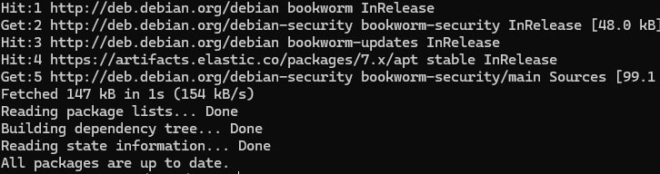

when installing the Graylog platform, referring to the installation guide.
For the installation phase using the command sudo apt install graylog-server -y for the Graylog-server service, I receive a message: Unable to locate package graylog-server, even if the package exists.
2. Describe your environment:

Hello @SAB
Did you run the ‘apt update’ prior to ‘apt install’?
Yes, apt update worked but apt install no
And to go one step back what is the out put of ‘sudo dpkg -i graylog-repo…’
I get this result ,

The same error, always unable to locate package graylog-server
Capture d’écran 2024-06-24 093430
