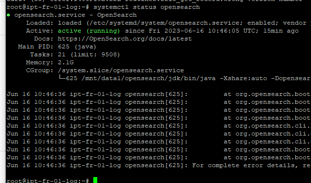

the OpenSearch service is fully up and running, all green.

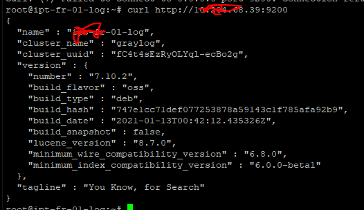

Because in this moment if i turn off the elasticsearch service, messages stop comming in.
So i presume the switch is not actually… done.

in here i can still see the Elasticsearch version, instead of the opensearch 1.3.2
this is the opensearch yml.

Can you share the errors shown in that screenshot from the opensearch service status?
Also are there any errors in the opensearch log itself (should be in /var/log/opensearch)?

opensearch errors cleared
still, GL is still using the elasticsearch instead of opensearch

Thing is that both ES and OS look like corectly working, but tge GL server is still using ES for gathering the logs, and i presume i need to make some setting in somewhere to tell GL to use opensearch…
I can’t get this one right…

[2023-06-20T14:29:23,384][INFO ][o.o.e.NodeEnvironment ] [ipt-fr-01-log] using [1] data paths, mounts [[/mnt/data1 (/dev/vdb)]], net usable_space [305.4gb], net total_space [1tb], types [ext4]
[2023-06-20T14:29:23,385][INFO ][o.o.e.NodeEnvironment ] [ipt-fr-01-log] heap size [2gb], compressed ordinary object pointers [true]
[2023-06-20T14:29:23,551][INFO ][o.o.n.Node ] [ipt-fr-01-log] node name [ipt-fr-01-log], node ID [9B8PITtmRuGTO55BIR4Rig], cluster name [graylog], roles [master, remote_cluster_client, data, ingest]
[2023-06-20T14:29:40,956][INFO ][o.o.a.b.ADCircuitBreakerService] [ipt-fr-01-log] Registered memory breaker.
[2023-06-20T14:29:43,117][INFO ][o.o.m.c.b.MLCircuitBreakerService] [ipt-fr-01-log] Registered ML memory breaker.
[2023-06-20T14:29:47,480][INFO ][o.o.t.NettyAllocator ] [ipt-fr-01-log] creating NettyAllocator with the following configs: [name=opensearch_configured, chunk_size=256kb, suggested_max_allocation_size=256kb, factors={opensearch.unsafe.use_netty_default_chunk_and_page_size=false, g1gc_enabled=true, g1gc_region_size=1mb}]
[2023-06-20T14:29:47,927][ERROR][o.o.b.Bootstrap ] [ipt-fr-01-log] Exception
java.lang.IllegalArgumentException: Unknown discovery type [single_node]
at org.opensearch.discovery.DiscoveryModule.(DiscoveryModule.java:227) ~[opensearch-1.3.2.jar:1.3.2]
at org.opensearch.node.Node.(Node.java:815) ~[opensearch-1.3.2.jar:1.3.2]
at org.opensearch.node.Node.(Node.java:319) ~[opensearch-1.3.2.jar:1.3.2]
at org.opensearch.bootstrap.Bootstrap$5.(Bootstrap.java:242) ~[opensearch-1.3.2.jar:1.3.2]
at org.opensearch.bootstrap.Bootstrap.setup(Bootstrap.java:242) ~[opensearch-1.3.2.jar:1.3.2]
at org.opensearch.bootstrap.Bootstrap.init(Bootstrap.java:412) [opensearch-1.3.2.jar:1.3.2]
at org.opensearch.bootstrap.OpenSearch.init(OpenSearch.java:178) [opensearch-1.3.2.jar:1.3.2]
at org.opensearch.bootstrap.OpenSearch.execute(OpenSearch.java:169) [opensearch-1.3.2.jar:1.3.2]
at org.opensearch.cli.EnvironmentAwareCommand.execute(EnvironmentAwareCommand.java:100) [opensearch-1.3.2.jar:1.3.2]
at org.opensearch.cli.Command.mainWithoutErrorHandling(Command.java:138) [opensearch-cli-1.3.2.jar:1.3.2]
at org.opensearch.cli.Command.main(Command.java:101) [opensearch-cli-1.3.2.jar:1.3.2]
at org.opensearch.bootstrap.OpenSearch.main(OpenSearch.java:135) [opensearch-1.3.2.jar:1.3.2]
at org.opensearch.bootstrap.OpenSearch.main(OpenSearch.java:101) [opensearch-1.3.2.jar:1.3.2]
[2023-06-20T14:29:47,964][ERROR][o.o.b.OpenSearchUncaughtExceptionHandler] [ipt-fr-01-log] uncaught exception in thread [main]
org.opensearch.bootstrap.StartupException: java.lang.IllegalArgumentException: Unknown discovery type [single_node]
at org.opensearch.bootstrap.OpenSearch.init(OpenSearch.java:182) ~[opensearch-1.3.2.jar:1.3.2]
at org.opensearch.bootstrap.OpenSearch.execute(OpenSearch.java:169) ~[opensearch-1.3.2.jar:1.3.2]
at org.opensearch.cli.EnvironmentAwareCommand.execute(EnvironmentAwareCommand.java:100) ~[opensearch-1.3.2.jar:1.3.2]
at org.opensearch.cli.Command.mainWithoutErrorHandling(Command.java:138) ~[opensearch-cli-1.3.2.jar:1.3.2]
at org.opensearch.cli.Command.main(Command.java:101) ~[opensearch-cli-1.3.2.jar:1.3.2]
at org.opensearch.bootstrap.OpenSearch.main(OpenSearch.java:135) ~[opensearch-1.3.2.jar:1.3.2]
at org.opensearch.bootstrap.OpenSearch.main(OpenSearch.java:101) ~[opensearch-1.3.2.jar:1.3.2]
Caused by: java.lang.IllegalArgumentException: Unknown discovery type [single_node]
at org.opensearch.bootstrap.Bootstrap.init(Bootstrap.java:412) ~[opensearch-1.3.2.jar:1.3.2]
at org.opensearch.bootstrap.OpenSearch.init(OpenSearch.java:178) ~[opensearch-1.3.2.jar:1.3.2]
… 6 more
