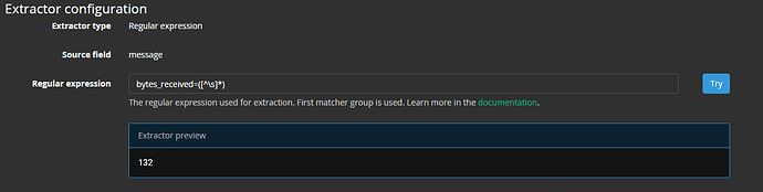

@isotecviac2022
Example using an REGEX extractor with an “Numeric” converter se if that helps.
If I had an example of the message. I probably would have done it for ya already :laughing:
