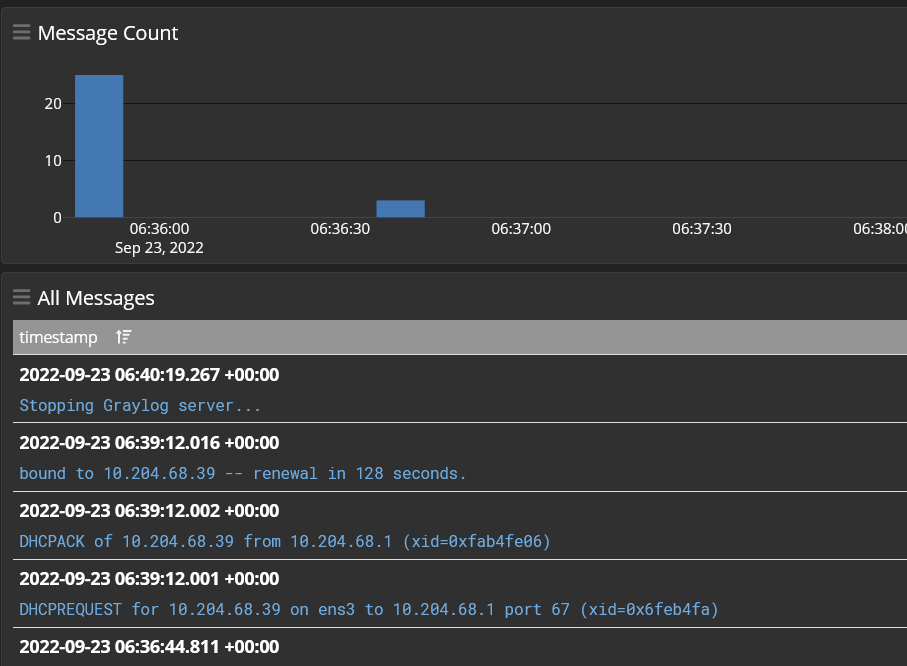

Connection refused while retrieving data for this widget
I found another topic for this, but that solution didn’t solved my problem - meaning, changing the port to 9200

i listed my cinfig files for ES
and GL config
