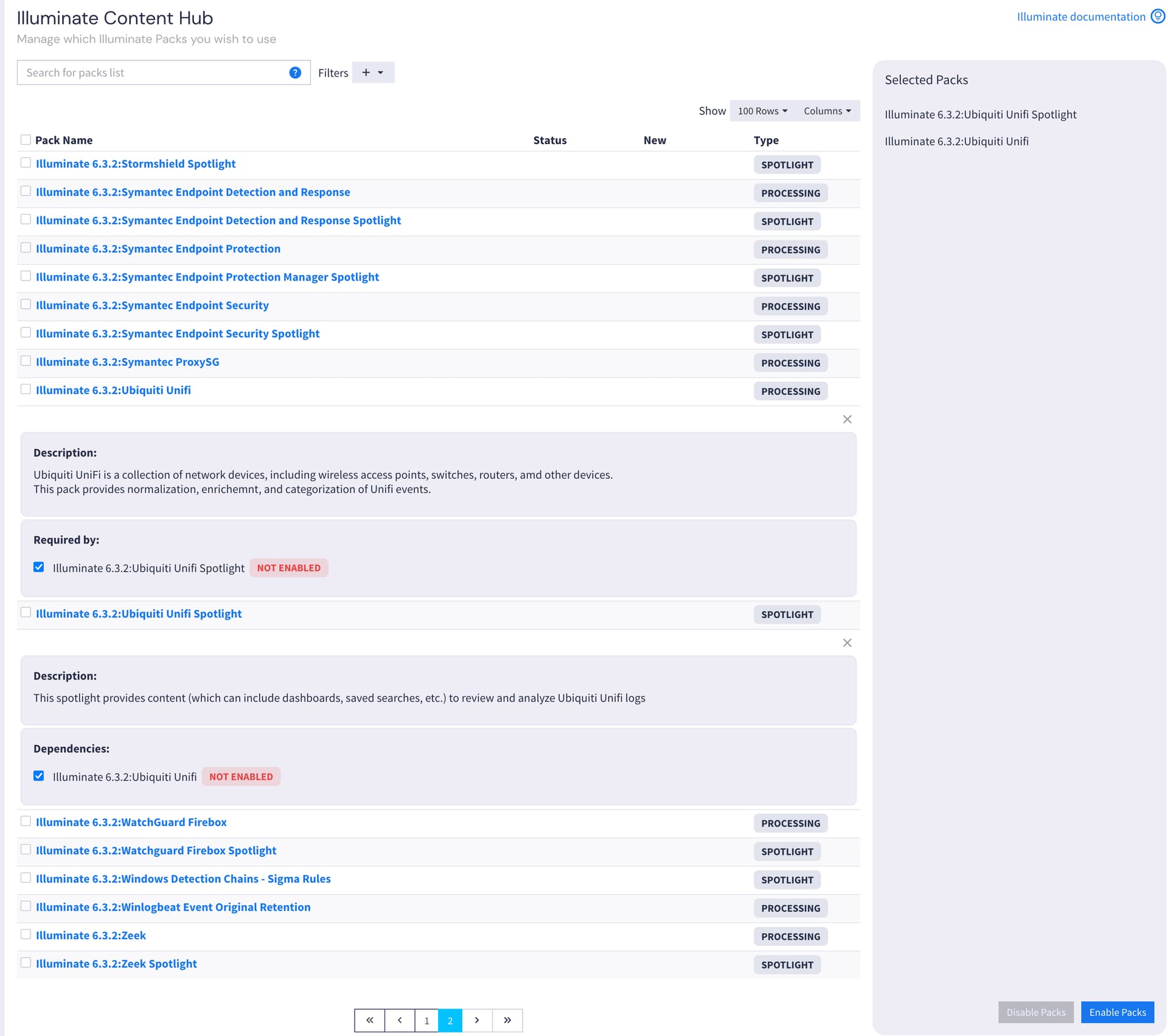

Actually I think there is a couple of bugs here.
The list of available Illuminate packs does not allow me to select them from installation except for certain cases (Netflow and a couple more)

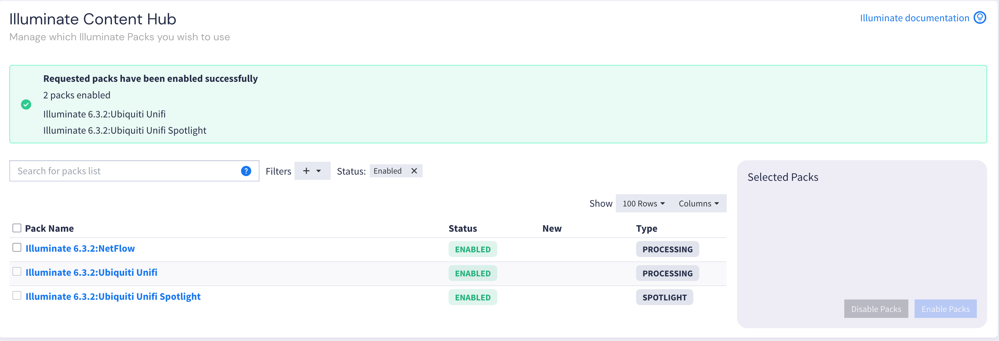

I can “open” one Illuminate pack, select its dependencies, and enable them. This looks like I actually installed them.
Doing this I “enabled” the Unifi content packs although I guess they are not working. Anyway it should not be possible to enable them in this way.
