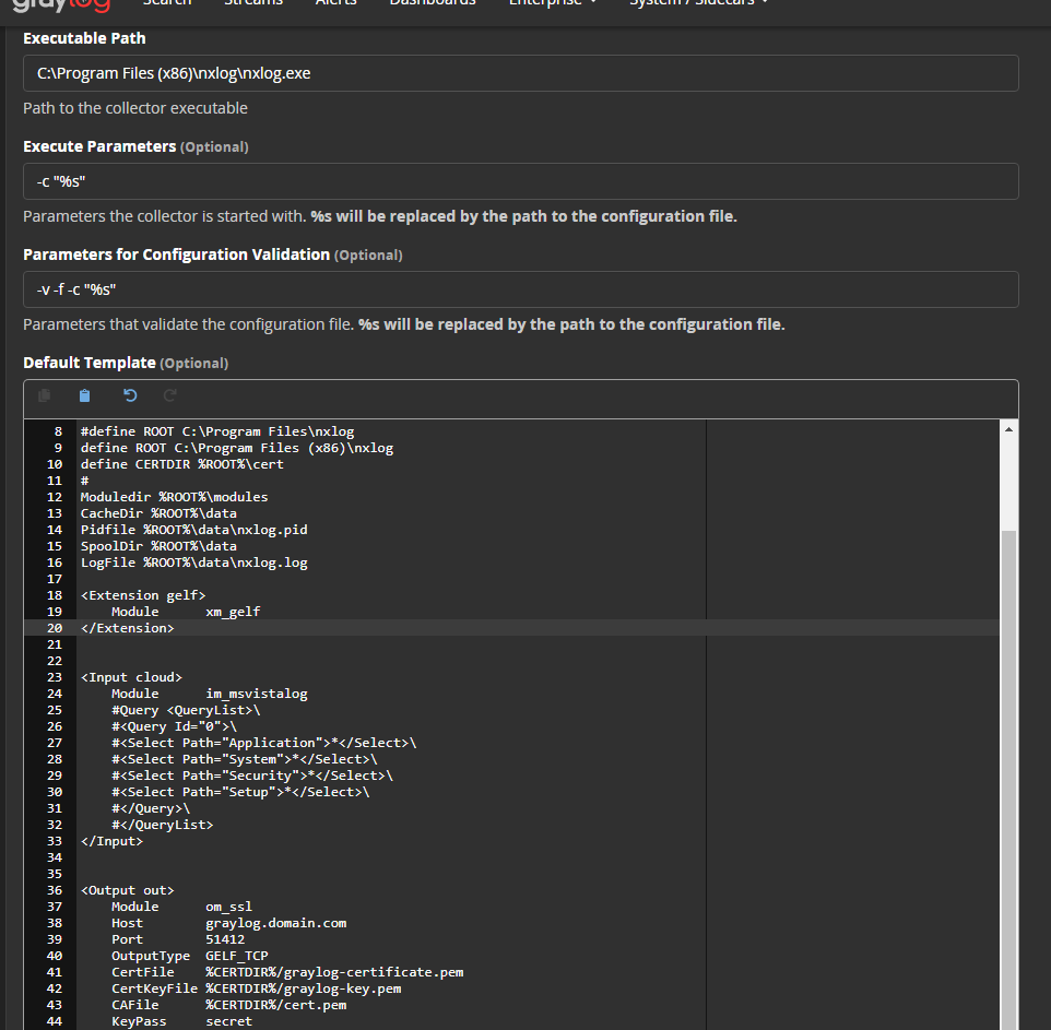

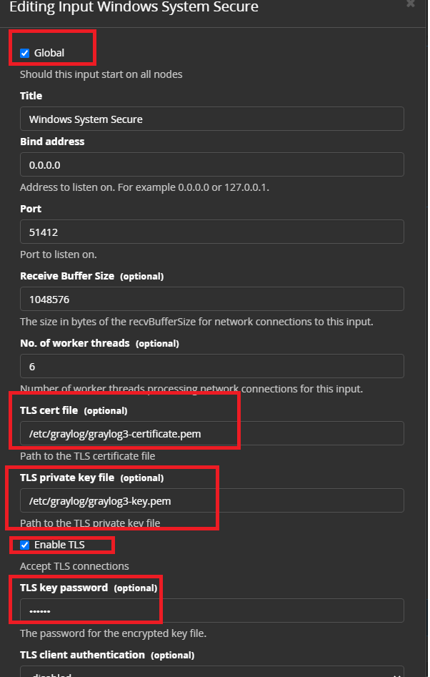

Something seams off about the following statements.
If all the Windows servers are pointing to GELF TCP Input.
And that GELF input is configured as shown below.
That configuration shows me that only this device graylog_server_FQDN is bound to that GELF Input.
If you created GELF input for TCP/TLS then it should look like this for all the windows devices within the LAN.
Not sure how the other windows devices are send messages.
Also, the certificates should also be on the remote device and log shipper should also be configured like so. This is an example of Nxlog config file.
<Extension gelf>
    Module      xm_gelf
 </Extension>
<Input zone-01>
    Module      im_msvistalog
    Query <QueryList>\
    <Query Id="0">\
    <Select Path="Application">*</Select>\
    <Select Path="System">*</Select>\
    <Select Path="Security">*</Select>\
    </Query>\
    </QueryList>
</Input>
<Output out>
    Module      om_ssl
    Host        graylog.domain.com
    Port        51412
    OutputType  GELF_TCP
    CertFile    %CERTDIR%/graylog3-certificate.pem
    CertKeyFile %CERTDIR%/graylog3-key.pem
    CAFile      %CERTDIR%/cert3.pem
    KeyPass     secret
    AllowUntrusted  true
    Exec $Hostname = hostname_fqdn();
    Exec $FullMessage = $raw_event;
    #Exec        to_syslog_snare();
</Output>
<Route >
    Path        zone-01 => out
</Route>
This is on Graylog Sidecar section /w ( NXLOG)
