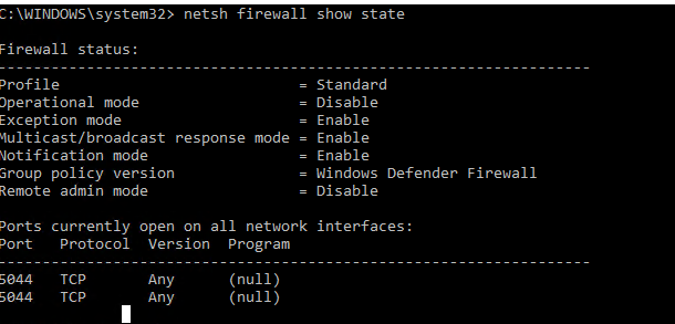

I monitor port 5044 is not open:
Port 5044 is not blocked:

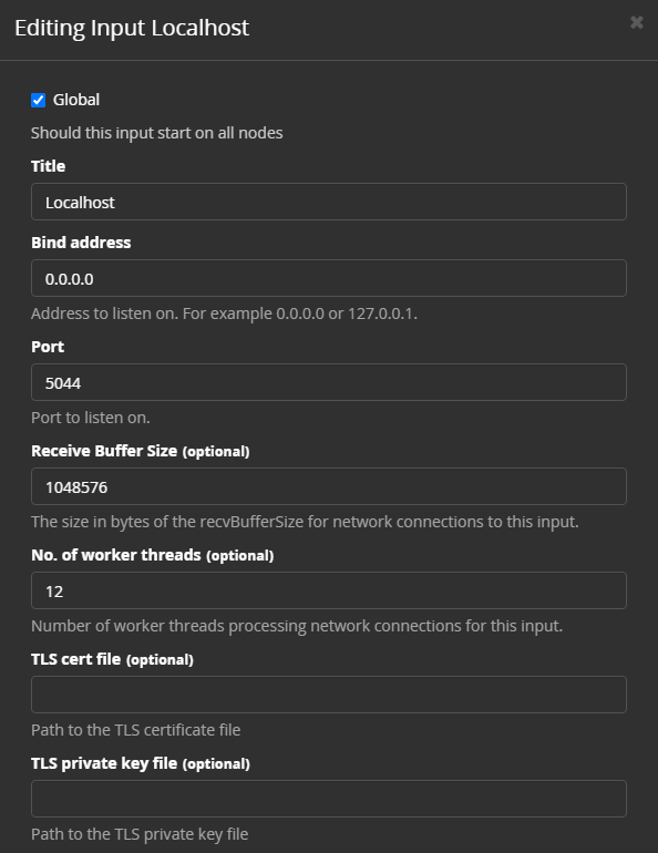

but input status look fine:
And configuration looks fine too:

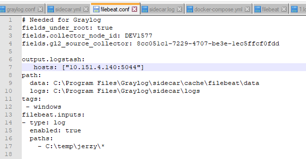

Here is generated filebat configuration:

Maybe to troubleshoot your issue have you tried to configure your Graylog INPUT as “Global”?
See if you get some type of a connection.

Thank you for your suggestion - I tried it but it didn’t help.
