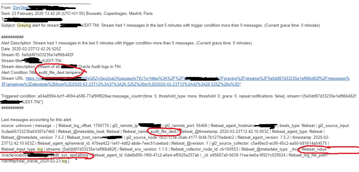

Could you provide a screenshot of your alert definition configuration and of the message which has triggered the alert (Don’t forget to redact any sensitive info)
settings below

the full condition is
filebeat_name: audit_file_dest AND NOT filebeat_value: /oracle/orabck//audit_sys_operations

it seems that adding quotes did solve the problem
filebeat_name:ā€œaudit_file_destā€ AND NOT filebeat_value:"/oracle/orabck/<REDACTED>/audit_sys_operations"
