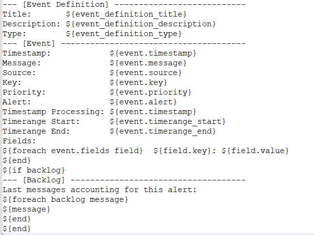

first of all I am getting this error using the body template that you provided
Secondly I tried with the default body template in notifications (email) but didn’t get the message or ip in the mail.
I have set the stream then pipeline rules as you have told me to do.

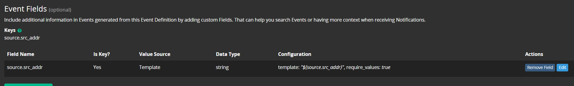

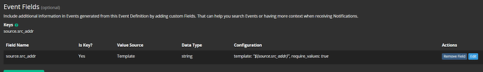

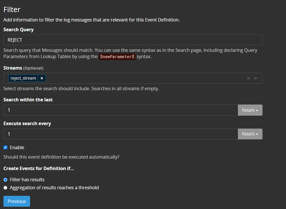

Here are the event definition settings:
I am not sure what is wrong here.
Hello,
Well that was an example of what you could do, I was not expecting a Copy & Paste, perhaps I should have mentioned that. That error means you needed a ${end} at the template.

1.I created a stream called Beats Filter I also removed it from “All message” In my case to save space.
2.Created event definition using the filter, Notice the quotes && the filter Preview? Its to insure I have correct configurations made.
3.I want to be alerted if more then 1 messages hits this stream that has “The Network Setup Service service entered the stopped state” within those messages. Which would be greater the “0” meaning if one messages arrives, Alert.

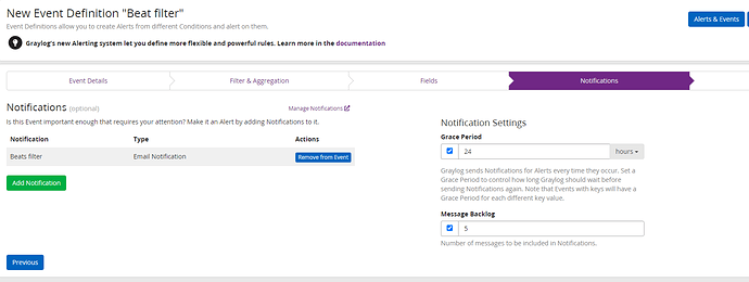

6.Back to my Event definition by adding the new Notification template. Noticed the Grace Period and backlogs section?

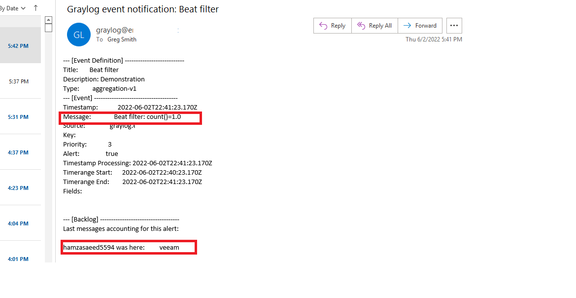

7.Email Results
Conclusion:
I creates a stream to fillter out specific logs, then Create a search filter in the event definition to filter even further and added a “COUNT” greater then “0” meaning more them one of those messages.
On the notification side I have a grace period for 24 hour with 5 backlogs for this example.
Configured my Notification template to only show “host_name” and from the last picture it also shows the count on how many message I have.
