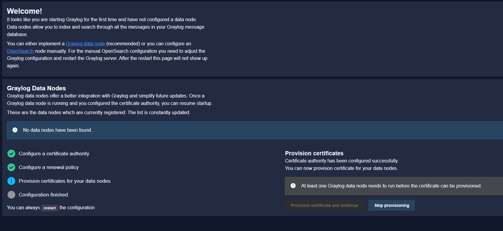

Then I started the services however, still getting the cert provisioning error in the GUI:
When I check the services, the datanode still seems to have a problem:

Its sat at this stage now for around 5minutes:
Is there anything else I need to do in the backend to get this certificate working?
I can ping the hostname of the server ok from itself, set a dns entry in the hosts file.
I checked hostname in datanode.conf file looks ok.

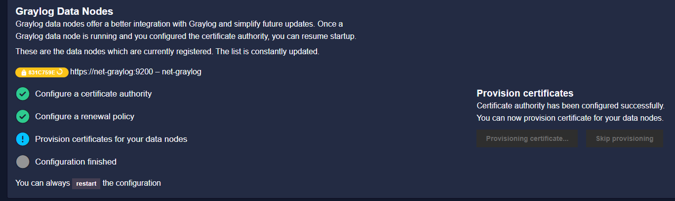

Any exceptions in the datanode log?
Hi Tomas,
2025-07-18T12:54:32.606Z ERROR [ProcessStateMachine] Failed to fire event PROCESS_STARTED
java.lang.RuntimeException: Failed to execute opensearch cli/usr/share/graylog-datanode/dist/opensearch-2.15.0-linux-x64/bin/opensearch-keystore
STDOUT/STDERR: Invalid initial heap size: -Xms4GB
Error: Could not create the Java Virtual Machine.
Error: A fatal exception has occurred. Program will exit.
I have 8GB of ram so increased heap size to:
# Default Java options for heap and garbage collection.
GRAYLOG_SERVER_JAVA_OPTS="-Xms4g -Xmx4g -server -XX:+UseG1GC -XX:-OmitStackTraceInFastThrow"
Then i stopped and started the 2 services and getting this now:
2025-07-18T13:02:22.257Z INFO  [OpensearchSecurityConfigurationBean] Opensearch Transport certificate has following serial number: 1752843740310
2025-07-18T13:02:22.258Z INFO  [OpensearchSecurityConfigurationBean] Opensearch Transport certificate has following validity: 2025-07-18T13:02:20.000+0000 - 2030-07-17T13:02:20.000+0000
2025-07-18T13:02:22.262Z INFO  [JerseyService] Server configuration changed, restarting Data node REST API to apply security changes
2025-07-18T13:02:22.263Z INFO  [OpensearchProcessService] OpenSearch starting up
2025-07-18T13:02:22.264Z INFO  [JerseyService] Shutting down HTTP listener at <10.157.255.250:8999>
2025-07-18T13:02:22.264Z INFO  [OpensearchCommandLineProcess] Creating opensearch keystore
2025-07-18T13:02:22.268Z INFO  [NetworkListener] Stopped listener bound to [10.157.255.250:8999]
2025-07-18T13:02:22.326Z INFO  [NetworkListener] Started listener bound to [10.157.255.250:8999]
2025-07-18T13:02:22.327Z INFO  [HttpServer] [HttpServer-2] Started.
2025-07-18T13:02:22.328Z INFO  [JerseyService] Started REST API at <10.157.255.250:8999>
2025-07-18T13:02:22.468Z ERROR [ProcessStateMachine] Failed to fire event PROCESS_STARTED
Try changing the opensearch_heap setting to 4g and restart the datanode service.

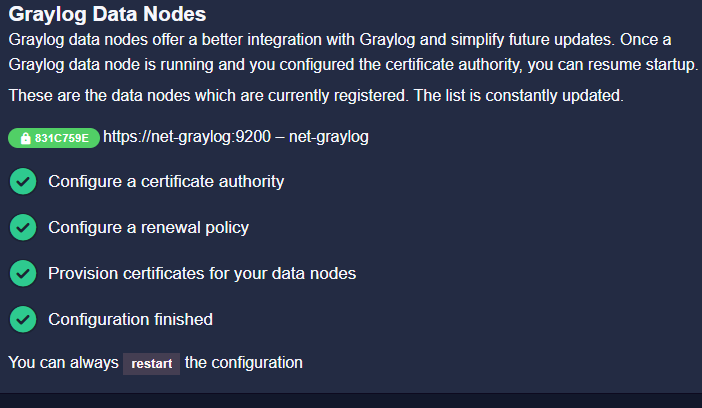

Yes, correct location, but the last line has to be
opensearch_heap = 4g
in order to configure 4GB. Java accepts only <size>[g|G|m|M|k|K] format, so the additional B makes the configuration value invalid and crashes the managed opensearch process. That’s why your preflight never finishes.
Hi Tomas,
You nailed it!
Thank you so much, that’s it operational now :smiley:
appreciate your speedy support.
Many thanks!
Glad I could help! Enjoy your new setup :partying_face:
