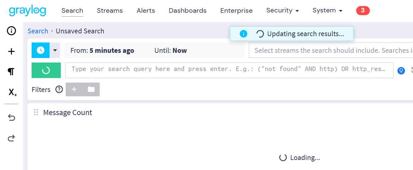

**1. Issue
Hello, Graylog was working fine until I replaced the IP address with the fully qualified domain and also added the new certificate for the FQDN
Below is the error:
2025-06-17T11:39:13.461Z WARN  [ProxiedResource] Failed to call API on node <1bb277fc-06c4-4bcf-8359-5XXXXXe97320>, cause: None of the TrustManagers trust this certificate chain. (duration: 9 ms)
2025-06-17T11:39:14.193Z WARN  [ProxiedResource] Failed to call API on node <1bb277fc-06c4-4bcf-8359-5XXXXXe97320>, cause: None of the TrustManagers trust this certificate chain. (duration: 5 ms)
2025-06-17T11:39:15.031Z WARN  [ProxiedResource] Failed to call API on node <1bb277fc-06c4-4bcf-8359-5XXXXXe97320>, cause: None of the TrustManagers trust this certificate chain. (duration: 5 ms)

Earlier i was accessing Graylog with the IP address and now i am trying to access it via URL and it works as well but data is not loading.
The error log you are posting is from server.log?
Yes and below are the recent logs
