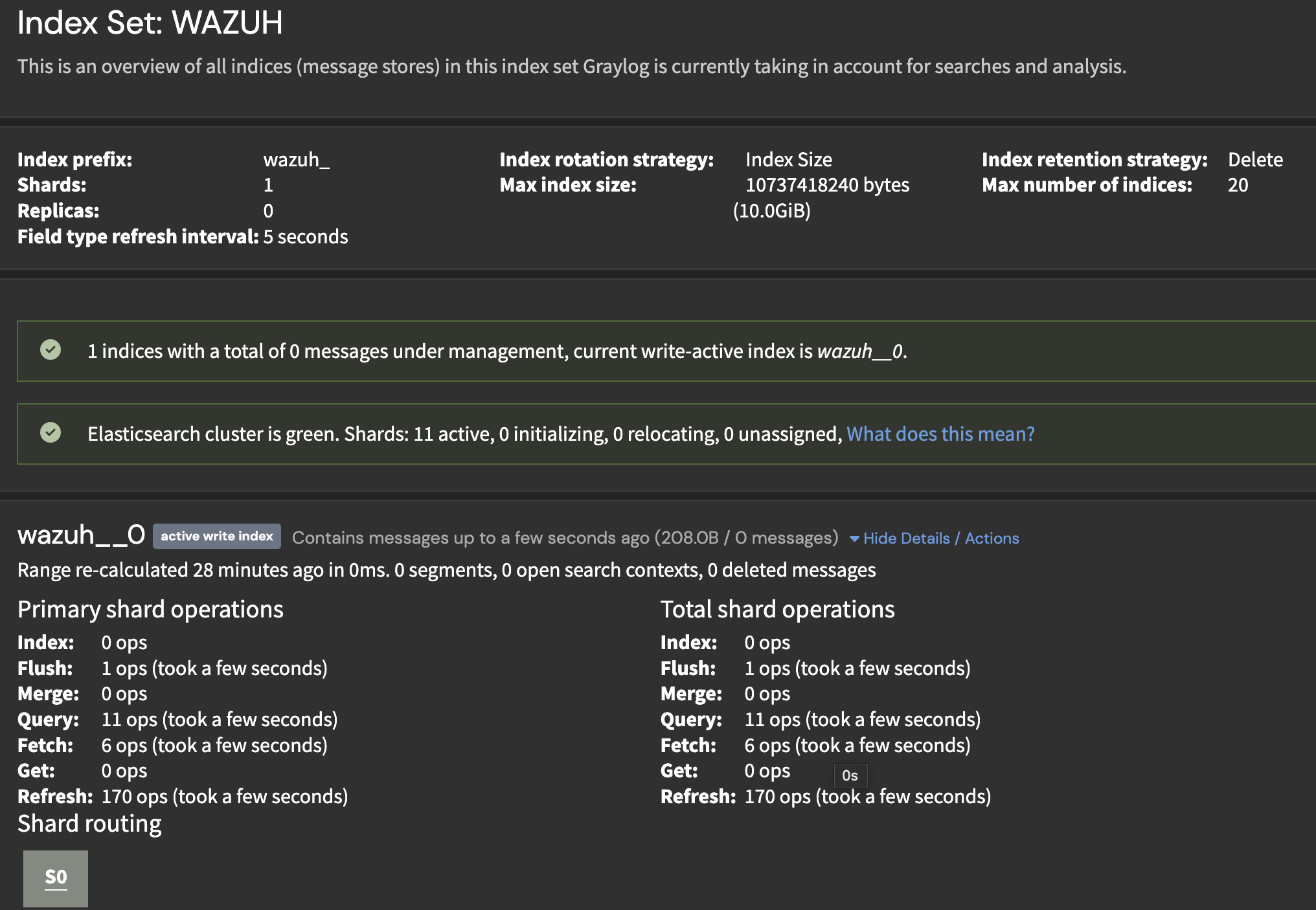

I created a new index under Graylog

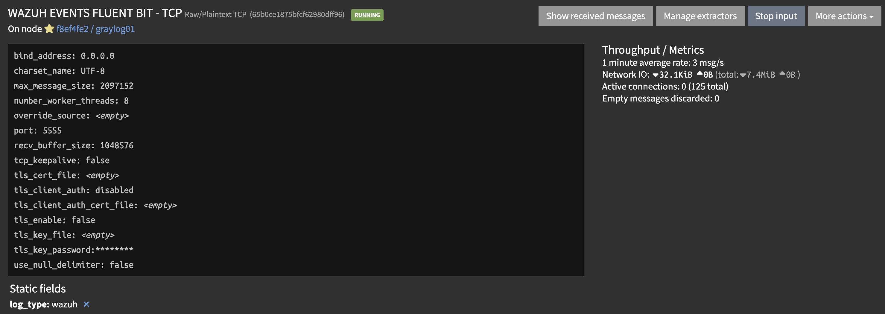

I created the input as follows with an additional static field “log_type:wazuh”
The static field “log_type:wazuh” is also included in incoming messages.

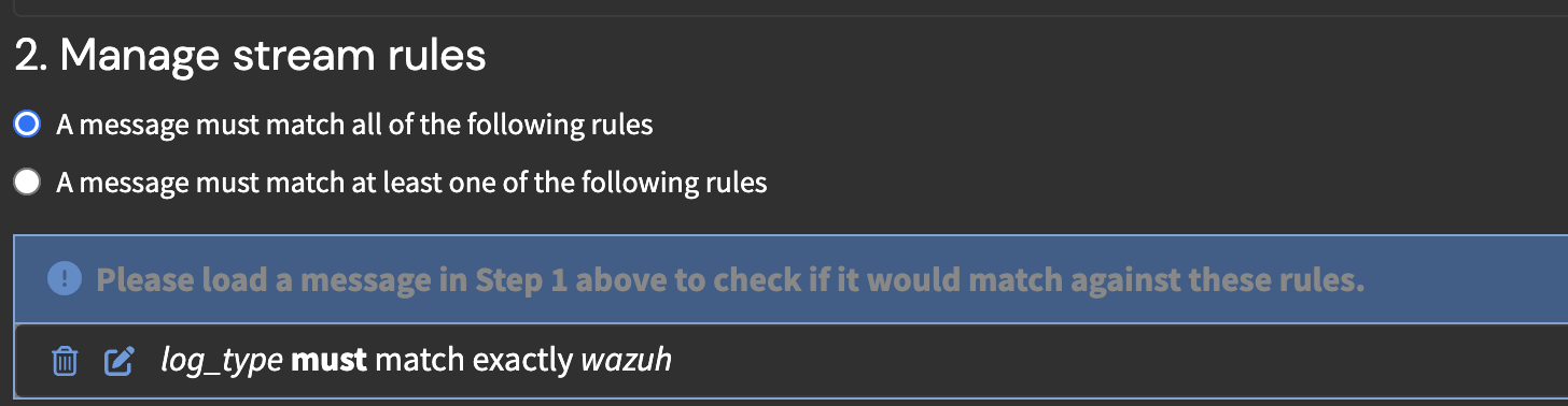

Now I have created a stream that should write the incoming messages with the field “log_type:wazuh” to the index “wazuh”. For this purpose, I added the corresponding rule to the stream. Unfortunately, the incoming messages are still written to the default index
