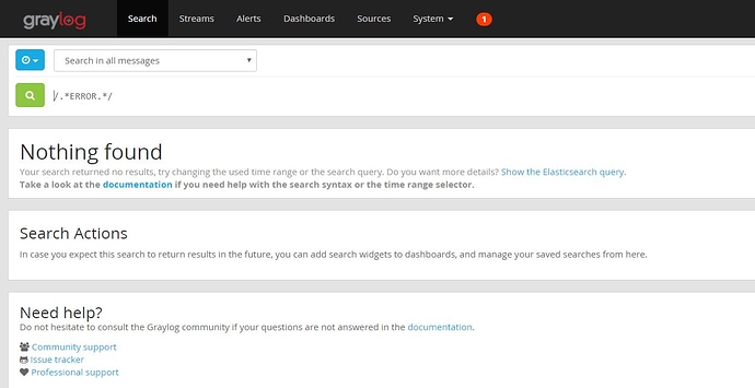

Hi Lindon,
I tried message:/. *ERROR.* / but it also not showing any result. any idea why these type of searches are not giving any result?
Sorry Vinay, I think the forum stripped out the wildcards in my previous post.
Try
/.*ERROR.*/

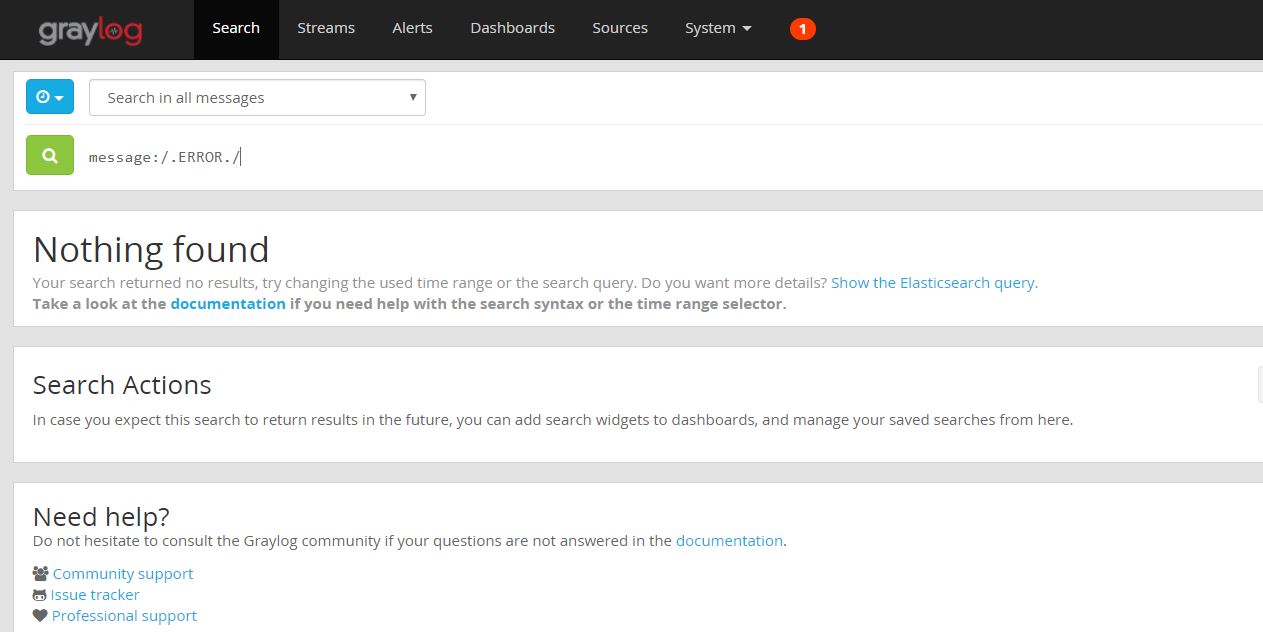

Hi Lindonm,
Thanks for the quick response but /.ERROR./ or message:/.ERROR./ does not gives any result but searching only ERROR does.i have included * wildcard with the search.

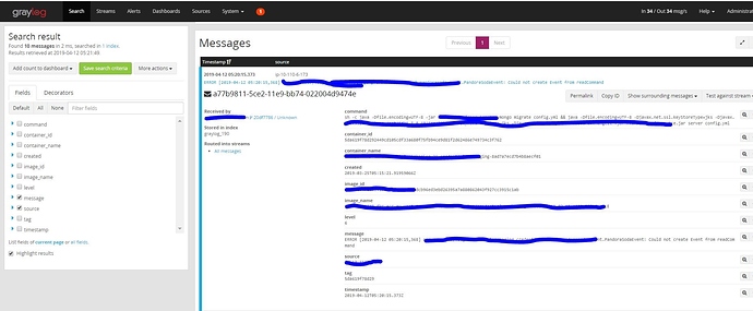

Are you able to show us a screenshot with an actual log result? (no search query). Include the column “message” in the output.
Thanks, the regex should definitely work then, this may be a bug. It will need someone who knows a lot more about Graylog, but I wonder if it’s something at the OS level, eg does a grep with regex work on that same system?
