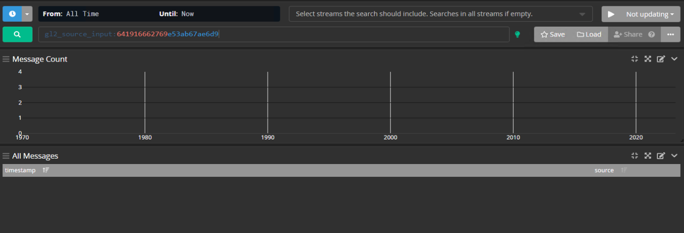

I used the following method and did not receive a message in message.
However, by adding an output to the log file and using Wireshark, I can confirm that the NXLOG message should have been sent out.

    OutputType GELF _UDP
</Output>
