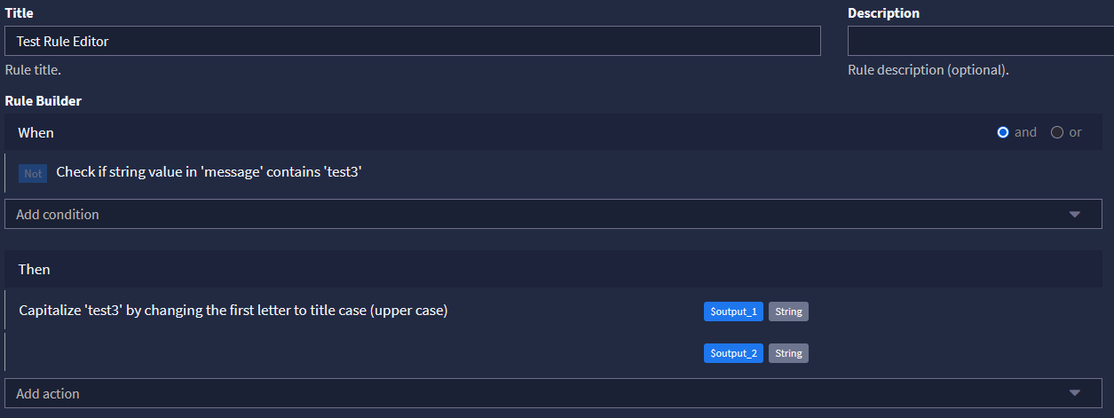

I nearly forgot to mention that the rule editor as a whole breaks too once I want to edit existing rules to add something new:
As can be seen in the screenshot, the newly added steps stay blank.

What baffles me is that once I saved a new rule, I can’t add new conditions or actions or at the very least I don’t see them. It looks like it’s included in the JSON message but won’t be displayed.
I added some marking to make it more clear:
Maybe it’s related to the same root cause though.

EDIT: Well, I don’t know if it’s related but actually there’s still the bug with new rule entries and edits being invisible. They do work and become visible once the rule is saved and opened again.
It looks like this after adding and editing something:
Once I saved and reopened the rule:
If it’s not related to the other issue I can also open a new thread for it.
