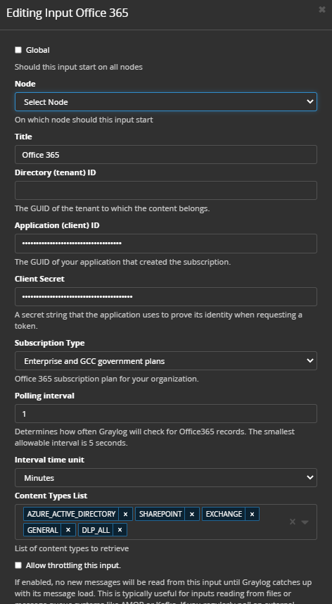

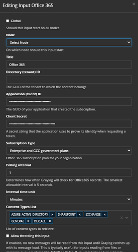

Yes, I’m using the “Office 365 Log events” input that is built into Graylog. Here is my current configuration :

Have you tries changing your polling interval?
Hi @tmacgbay,
Yes, I changed it from 1min to 5mins and the same thing happens…
Can you post your connection settings to Azure? Obfuscated where necessary of course. Settings on the Azure side would be helpful too. Can we assume that all the errors in the logs etc. posted up are the same now as they were before? If they have changed any please post those too.
