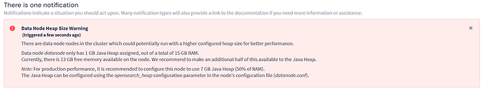

Hello,
I am getting the notification on GraylogUI which says as below screenshot. I am using Graylog 6 container.
I tried the following in my docker-compose but still no luck. I tried to set in both data node and graylog container but not reflected.

Hi @I_am_winner
There is a datanode config property opensearch_heap that you need to configure in your datanode.conf, or alternatively, by configuring env property GRAYLOG_DATANODE_OPENSEARCH_HEAP.
This property and the notification itself is refering to the memory that will be used by the managed opensearch process in datanode.

@Tdvorak It is setting up but still it is showing the heap notification and suggested that minimum 50% of RAM should be set for example for 16GB RAM, need to set 7GB.
I set to 7g but now the graylog is not able to access with FQDN but able to access with IP.
