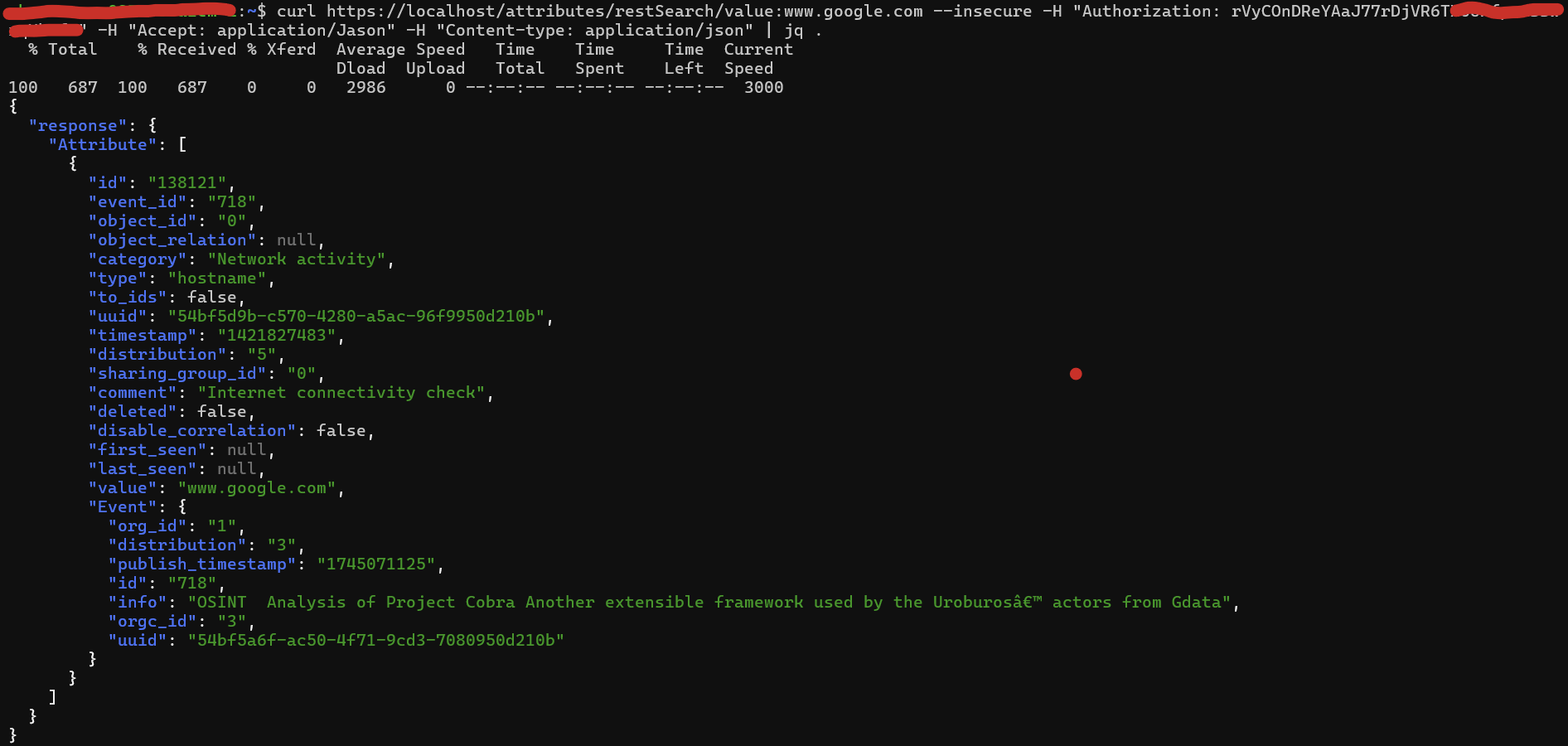

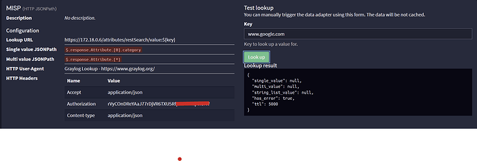

I tried integrating MISP with graylog, but whenever I lookup for a value it returns null. I can curl to MISP and get the correct values on cli but not on GUI. Moreover, curl only works with --insecure

This is what curl returns
So first guess is that you are using a cert graylog doesnt trust, you would need to add that cert to the java key store for graylog to trust it, also have a look in server.log for what is going on.
