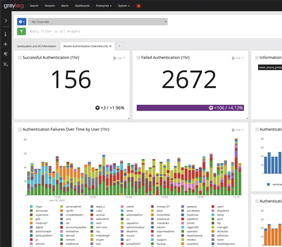

A standard use of a platform like Graylog is to feed in your firewall logs, and then check the source and destination IPs of each request against geolocation and against threat libraries to detect external access/threats or internal illict activity. Good for detecting if someone is using the office network for torrenting or cryptomining too!

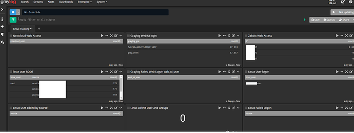

Here is an example of my lab, please take note this Dashboard for my Linux device ONLY.
Here is an example of my lab, please take note this Dashboard for my Windows device ONLY.
On both of those screenshots there is a stream with Event Definition attached for alerting if need be.

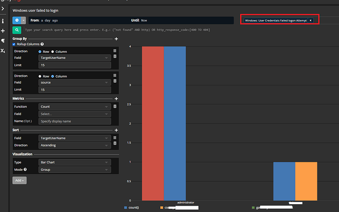

Hello,
Here is my failed logon attempt.
here is User Account was lockout
If you noticed there both attached to a stream.
Hope that helps

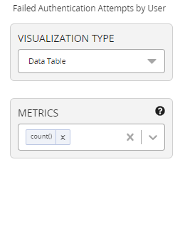

Few things I want to ask you.
you have different settings then my graylog.
I dont have all these options. Like in Metrics section I dont have Field or name attributes.
