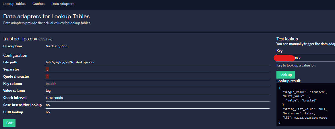

1.Created a Data Adapter using a CSV file and placed the file on the server.
→ I tested the adapter, and the lookup returns the correct value. Fig.01

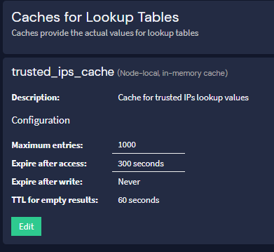

2. Configured the Cache for the adapter. Fig.02

I cant see any line for looking up your ip address against the lookup-table.
I looks like you check the ip address with the trusted_min / _max values and not against your csv?
Your pipeline should contains something like this:
let lookup_result = lookup_value(“trusted_ips_lookup”, source_ip);
After this, you have to store the output-value from the lookup-table in your variable
