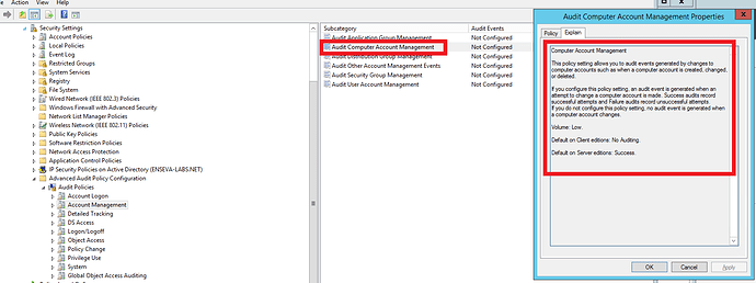

What we noticed with this configuration above is that it does pick up a lot of Default Events generated from Hyper-V servers, BUT we had to enable the proper Audit logging in the Domain controlers and what I mean by that is some events did not come through.
Here is example below just to give you a better understanding what we had to go though.
To make this happen as shown below.
We had to configure this in our domain control as follow.
Step 1: going to your Group Policy management console → Domain policy → Computer configuration → Policies → Windows Settings → Security Settings → Local Policies → Audit Policy/Advanced audit policy configuration.
Step 2: Select the events you want to audit.
Step 3: Now to view the AD event logs for these, go to Administrative tools → Event Viewer.
Step 4: Select the type of AD audit logs that you wish to view (ex: Application, System, etc.).
So, the moral of the story is if you need something unique or verbose logging you may have to enable certain Audit logging configurations in your domain controller and/or Hyper-v server.
Hope this helps.
