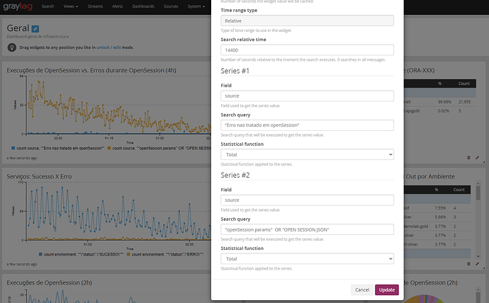

I’m amazed how a multi series widget was created here.
I started working with graylog and saw some old widgets created here, but I can’t find anywhere how this was done, there’s nothing about multi series in the documentation, I didn’t find anything like it on google, I didn’t find any example of someone who has done something similar.

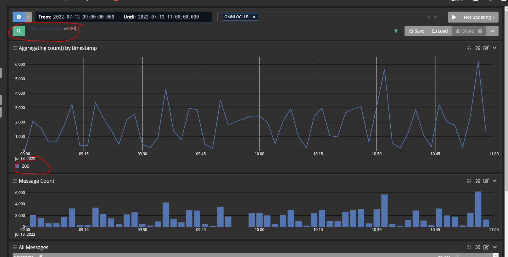

When I click on the play icon nothing happens.
Below configuration.

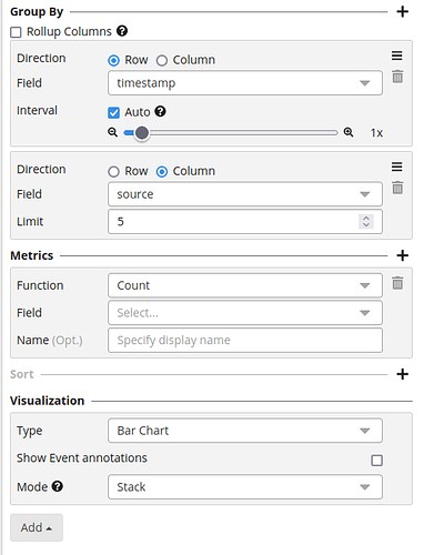

In modern Graylog 4.2/4.3 you will use the “Group By” like this:
Row → timestamp: Splits up the values of the x-axis by time
Column → source: Splits up the different values of the “source” field into different buckets
There is no individual search-query for each of them though.

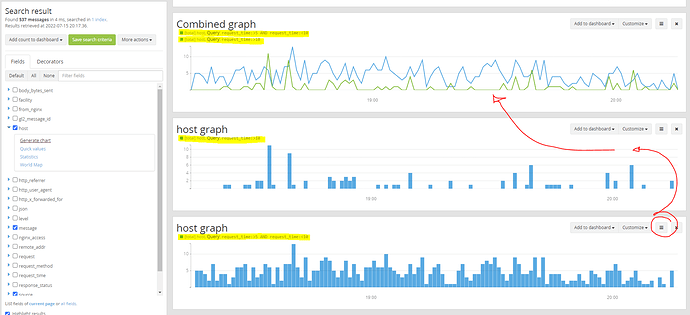

Ow Lord… is so easy! I found it!
The feature name is STACKED CHART!
It’s very simple, just dragging one graph inside the other…

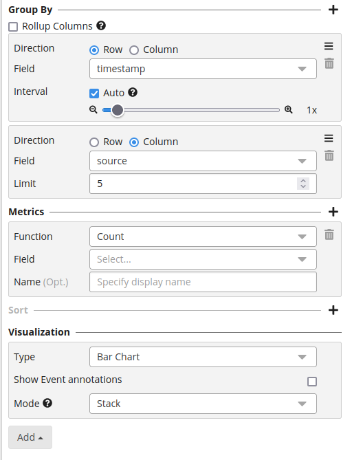

I couldn’t do it, the line chart doesn’t have that option and when the search changes, all the charts change.
Sorry, they won’t let me post multiple photos in the same message.
Query change, results change.
In the old version you can create graphs and it keeps the query
@gsmith
In this example I’m using http code, but what I need is to present the different processing times of the request, just like the example of the old version.
“request_time:>5 AND request_time:<10” and “Query: request_time:>10” in same graph.
