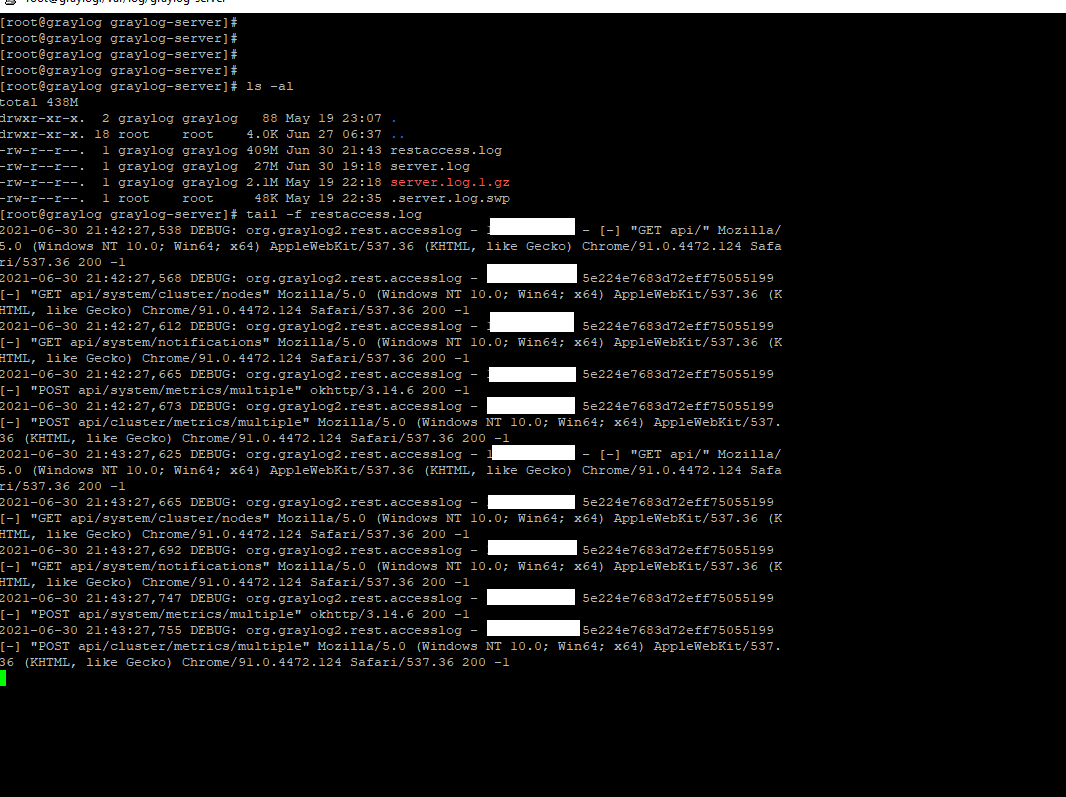

Hello & Welcome
Looking over you config file and comparing it to mine. I noticed somethings might be out of place.
To give you a better Idea here is mine.
<?xml version="1.0" encoding="UTF-8"?>
<Configuration packages="org.graylog2.log4j" shutdownHook="disable">
    <Appenders>
        <RollingFile name="rolling-file" fileName="/var/log/graylog-server/server.log" filePattern="/var/log/graylog-server/server.log.%i.gz">
            <PatternLayout pattern="%d{yyyy-MM-dd'T'HH:mm:ss.SSSXXX} %-5p [%c{1}] %m%n"/>
            <Policies>
                <SizeBasedTriggeringPolicy size="50MB"/>
            </Policies>
            <DefaultRolloverStrategy max="10" fileIndex="min"/>
        </RollingFile>
        <!-- Internal Graylog log appender. Please do not disable. This makes internal log messages available via REST calls. -->
        <Memory name="graylog-internal-logs" bufferSize="500"/>
        <!-- Simple appender that writes access log to specified file -->
        <File name="RestAccessLog" fileName="/var/log/graylog-server/restaccess.log" append="true">
            <PatternLayout pattern="%d %-5p: %c - %m%n"/>
        </File>
        <RollingFile name="RestAccessLog" fileName="/var/log/graylog-server/restaccess.log"  filePattern="/var/log/graylog-server/restaccess.log.%i.gz">
            <Policies>
            </Policies>
        </RollingFile>
    </Appenders>
    <Loggers>
         <!-- RestAccessLogFilter -->
        <Logger name="org.graylog2.rest.accesslog" level="debug" additivity="false">
                <AppenderRef ref="RestAccessLog" level="debug"/>
                <AppenderRef ref="STDOUT" level="info"/>
         </Logger>
        <!-- Application Loggers -->
        <Logger name="org.graylog2" level="info"/>
        <Logger name="com.github.joschi.jadconfig" level="warn"/>
        <!-- Prevent DEBUG message about Lucene Expressions not found. -->
        <Logger name="org.elasticsearch.script" level="warn"/>
        <!-- Disable messages from the version check -->
        <Logger name="org.graylog2.periodical.VersionCheckThread" level="off"/>
        <!-- Silence chatty natty -->
        <Logger name="com.joestelmach.natty.Parser" level="warn"/>
        <!-- Silence Kafka log chatter -->
        <Logger name="org.graylog.shaded.kafka09.log.Log" level="warn"/>
        <Logger name="org.graylog.shaded.kafka09.log.OffsetIndex" level="warn"/>
        <Logger name="org.apache.kafka.clients.consumer.ConsumerConfig" level="warn"/>
        <!-- Silence useless session validation messages -->
        <Logger name="org.apache.shiro.session.mgt.AbstractValidatingSessionManager" level="warn"/>
        <Root level="warn">
            <AppenderRef ref="rolling-file"/>
            <AppenderRef ref="graylog-internal-logs"/>
        </Root>
    </Loggers>
</Configuration>
This shows in my /var/log/graylog directory.
Hope that helps
EDIT: I just noticed you using the Enterpise version, so that may not help. Just an idea, did you restart Graylog service after making changes?
