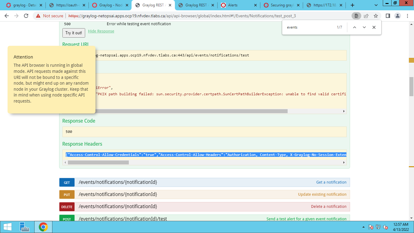

Graylog to nucool integration issue (Error: PKIX path building failed: sun.security.provider.certpath.SunCertPathBuilderException: unable to find valid certification path to requested target)
1. Describe your incident:
I am trying to integrate graylog with nucool system using webhook URL provided by nucool system and getting pkix path building failed error. I am using graylog alert http notification feature to implement this.
2. Describe your environment:

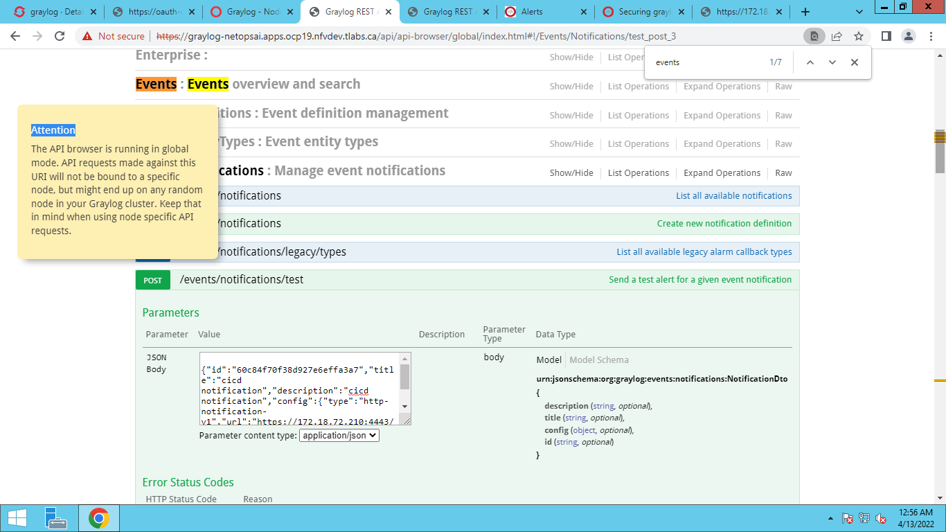

Looking for a solution on how to fix this issue . api response and payload details are given below for reference.
https://graylog-netopsai.apps.ocp19.nfvdev.tlabs.ca/api/events/notifications/test
{“id”:“60c84f70f38d927e6effa3a7”,“title”:“cicd notification”,“description”:“cicd notification”,“config”:{“type”:“http-notification-v1”,“url”:"https://172.18.72.210:4443/probe/webhook/NetOps/"}}
response header: {“Access-Control-Allow-Credentials”:“true”,“Access-Control-Allow-Headers”:“Authorization, Content-Type, X-Graylog-No-Session-Extension, X-Requested-With, X-Requested-By”,“Access-Control-Allow-Methods”:“GET, POST, PUT, DELETE, OPTIONS”,“Access-Control-Allow-Origin”:“https://graylog-netopsai.apps.ocp19.nfvdev.tlabs.ca”,“Access-Control-Max-Age”:“600”,“Connection”:“keep-alive”,“Content-Length”:“178”,“Content-Type”:“application/json”,“Date”:“Wed, 13 Apr 2022 04:56:33 GMT”,“Server”:“nginx/1.21.6”,“X-Graylog-Node-Id”:“d9b29696-31fe-47e4-8eab-55577f654583”,“X-Runtime-Microseconds”:“89328”}
