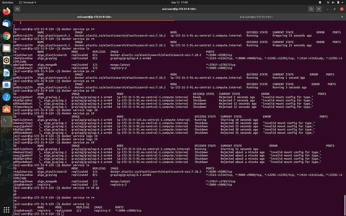

After deploying the stack the graylog service is stuck at accepted state. Tried a lot of work around but nothing seems to work.
Description of steps you’ve taken to attempt to solve the issue
Nothing appears in logs too. The process always shows accepted state for graylog service. The elastic search and mongodb are up.

Is this using Docker Swarm? I wonder if the node you’re pushing it to has enough RAM and CPU to run the container. This sounds like it might be a configuration issue.
Hey Donald,
Yeah, It is part of the swarm. Yesterday I have cleaned some memory from the virtual machine. I am now seeing this error.
I tried to bind mount the GeoLite2-City.mmdb from the virtual machine, as you can see in the volumes /etc/graylog/server:/etc/graylog/server. Without this mount it was throwing the error about the geoIP database file not exist at /etc/graylog/server/GeoLite2-City.mmdb.
What am I doing wrong?
