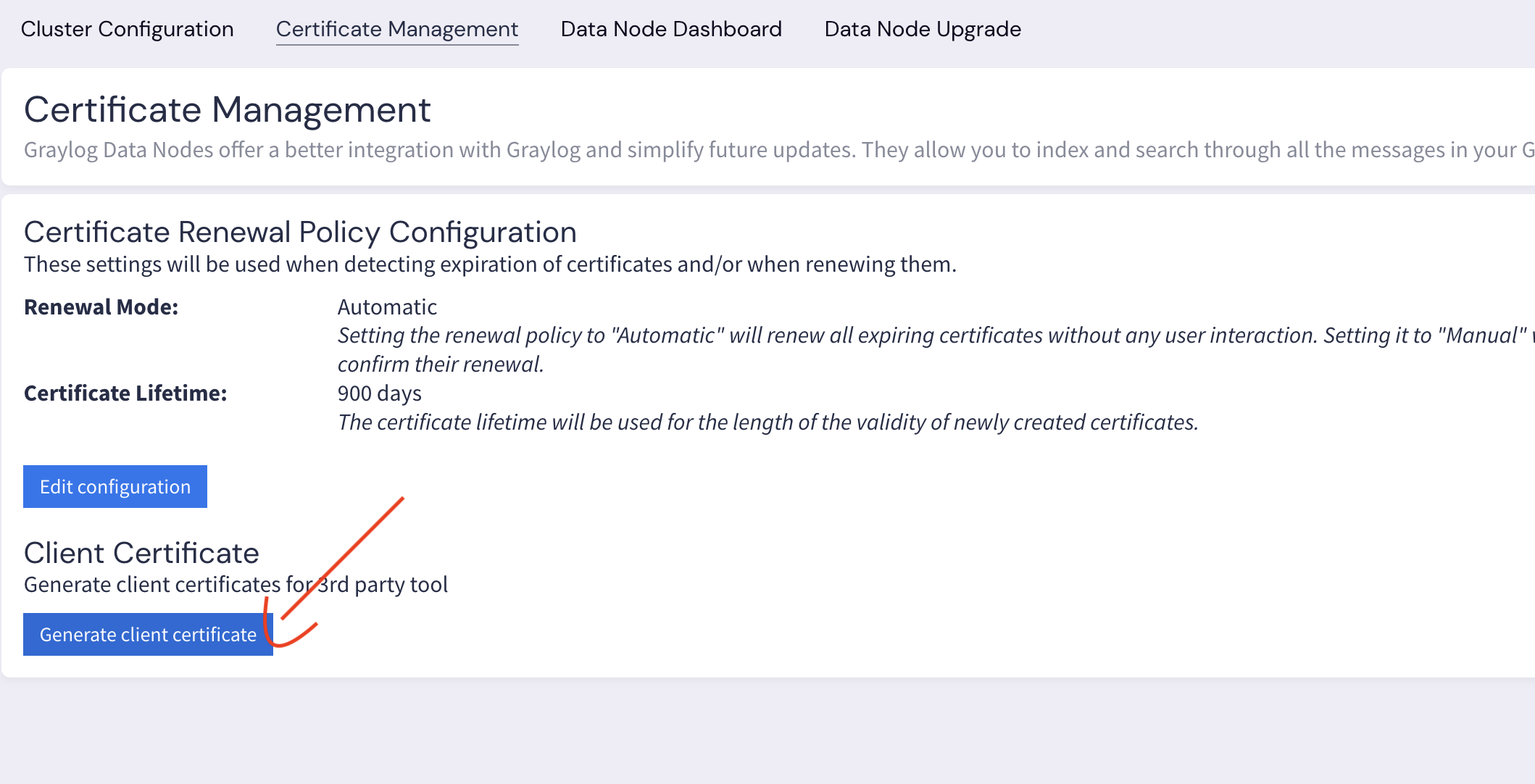

In order to query the Opensearch API you would need to generate a client cert from within the Graylog UI under system/cluster management and then the “Certificate Management” tab. Use the “Generate client certificate” option.
Ok, so I’ve generated the certificates and created them manually on linux. I’m executing the command again with newly created files, but it seems i have to do something else:
curl: (51) SSL: no alternative certificate subject name matches target host name ‘graylog.DOMAIN.NAME’
The error suggests you are not using the hostname of the Data Node, under System/Cluster Management you should be able to see the hostname of your Data Node. Try that in the curl.
Seems that it worked, but errors still occur. However this is the result:
