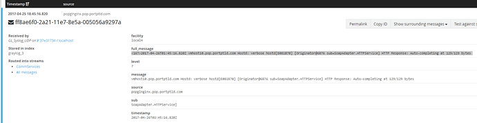

One thing I noticed on the UDP syslog input is that the source is coming into Graylog as the load balancer’s DNS name - not the source of the actual server sending the logs. This isn’t the end of the world, but it also isn’t ideal.

And here is the full message:
<167>2017-04-26T01:45:16.820Z vmhost10.pop.portptld.com Hostd: verbose hostd[E081B70] [Originator@6876 sub=SoapAdapter.HTTPService] HTTP Response: Auto-completing at 129/129 bytes
Screenshot of the message in graylog:.
Which version of Graylog are you using? Graylog 2.2.3 should correctly parse the syslog message you’ve provided.
Also, what kind of client does create these syslog messages?
Output of a quick test case using Graylog’s syslog parser:
fields = {HashMap@3161}  size = 7
 0 = {HashMap$Node@3166} "level" -> "7"
 1 = {HashMap$Node@3167} "full_message" -> "<167>2017-04-26T01:45:16.820Z vmhost10.pop.portptld.com Hostd: verbose hostd[E081B70] [Originator@6876 sub=SoapAdapter.HTTPService] HTTP Response: Auto-completing at 129/129 bytes"
 2 = {HashMap$Node@3168} "_id" -> "117f97c0-2a59-11e7-80da-56ae9a9f0542"
 3 = {HashMap$Node@3169} "source" -> "vmhost10.pop.portptld.com"
 4 = {HashMap$Node@3170} "message" -> "vmhost10.pop.portptld.com Hostd: verbose hostd[E081B70] [Originator@6876 sub=SoapAdapter.HTTPService] HTTP Response: Auto-completing at 129/129 bytes"
 5 = {HashMap$Node@3171} "facility" -> "local4"
 6 = {HashMap$Node@3172} "timestamp" -> "2017-04-26T01:45:16.820+00:00"
Graylog 2.2.3+7adc951.
This is coming from a VMWare VMHost.
