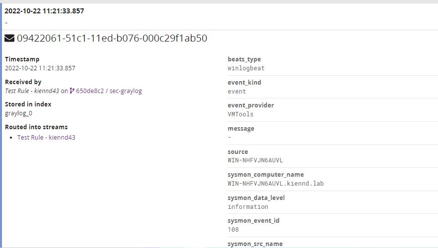

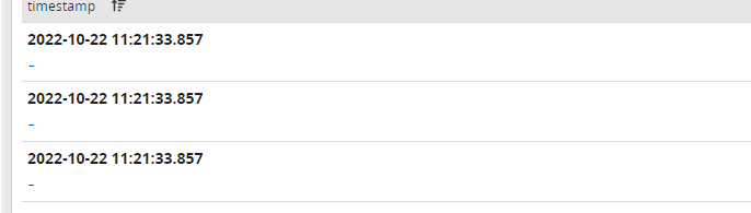

i collected log from my window DC by sidecar latest version (before winlogbeat)
but in input, message only display hyphens “-” , and message extend aslo display full content of message.
how can i fix this?

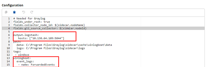

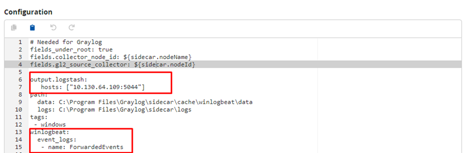

here is my config sidecar.
i dont have any exatroctors.
hello,
Ok I see your using Windows Forwarded events. So I assume that this windows device is the middle man for transporting logs files. If this is correct, Check the log/s for a message body. When you see "-" in a field, Elasticsearch could not identify it to place data in that field OR it was remove by other means configured in Graylog.

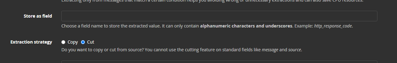

Example in this picture below, this shows Cut is enabled. What is does is remove data from the field, but since you stated you don’t have extractors or pipelines we probably can rule that out.

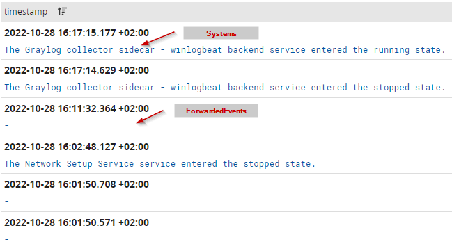

when i collect another log , for example: system log, it’s didn’t show hyphens
image (1)
image.
but message in ForwardedEvent maybe correctly.
Hello,
Ok this is weird, Windows System Events seam to work but your Forwarded Events do not.
Thanks for testing that, So this leads use to the messages/logs in Forwarded Events.

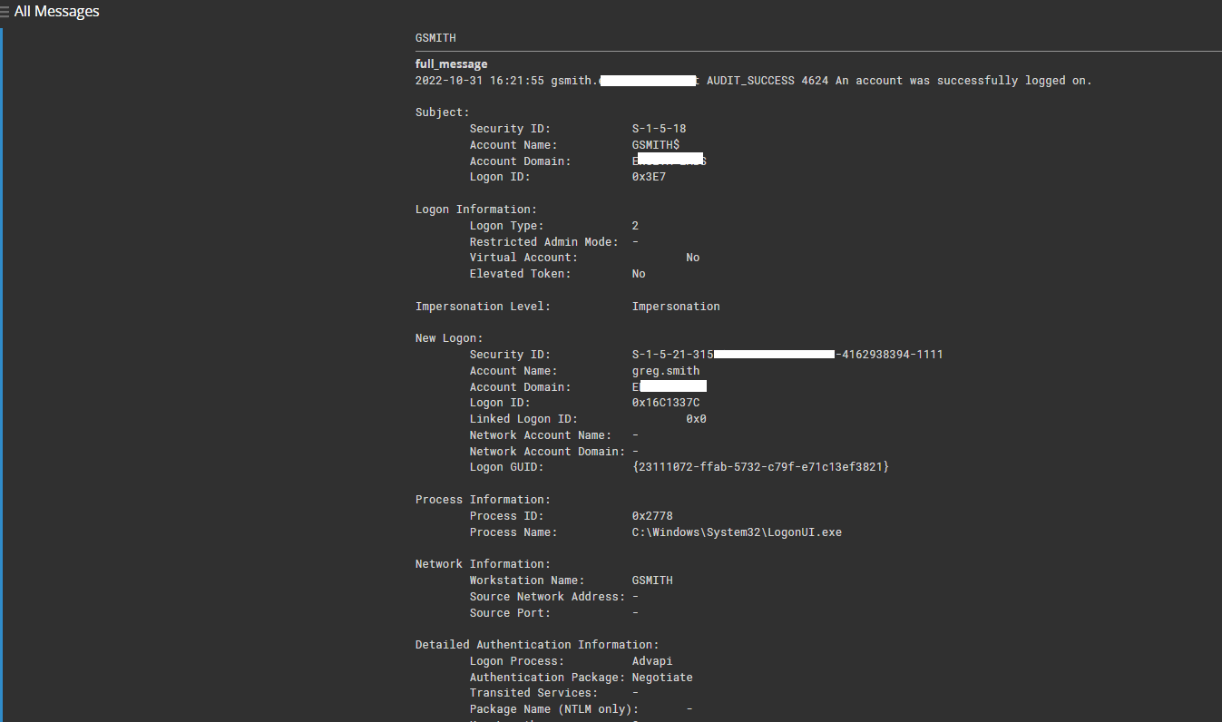

So something is funky with the Forwarded Events logs. For example, here is my lab, BUT this is not a Forwarded Events…
