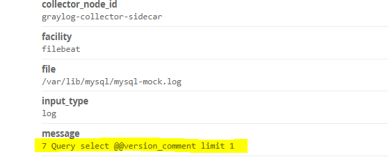

Splitting the message using \t we can parse the message.
The strange situation is that on graylog the massage value that I can use and parse is trimmed
The empty spaces are missing! Why?
So, can somebody explain me what happen? Who trim the message?

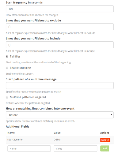

What’s your Filebeat Configuration?
Hi @jochen
this is my filebeat.yml

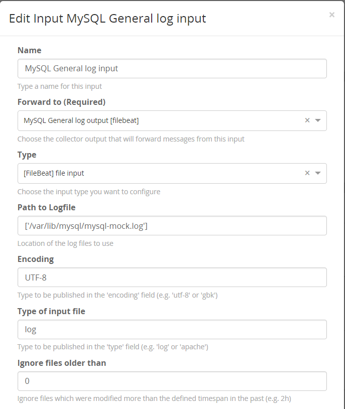

that comes from this Graylog collectors configurations:
Do you think that there could be a misconfiguration?
