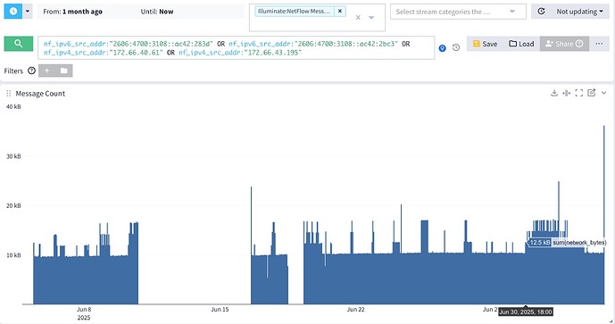

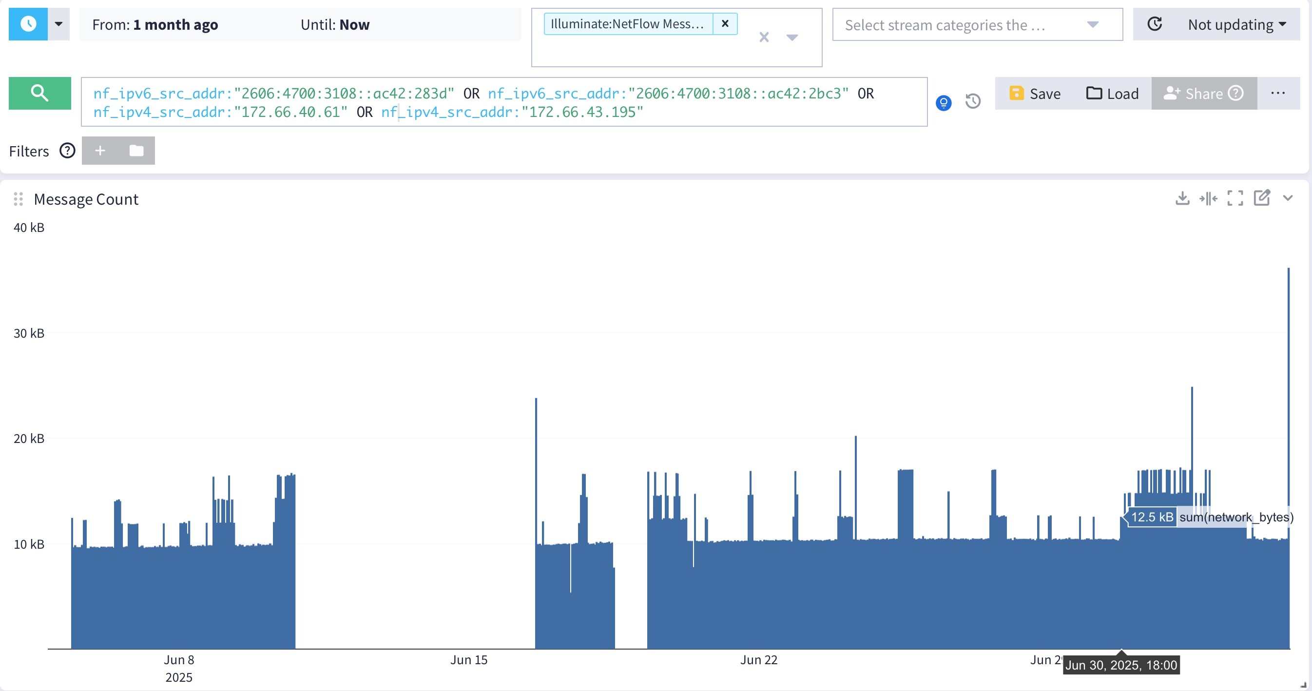

Did anything happen on Graylog API servers on June 30th? I am checking the amount of data exchanged per hour with them (Netflow records) and I see that the pattern seems to be different.
