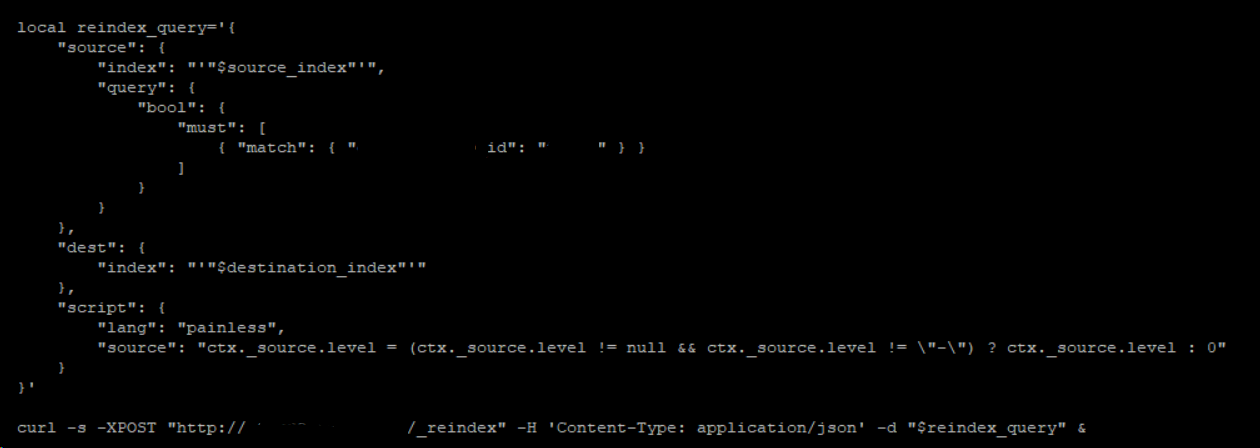

I put the information with a script that performs several checks and finally the function that reindexes one index by copying another is the one you can see below:

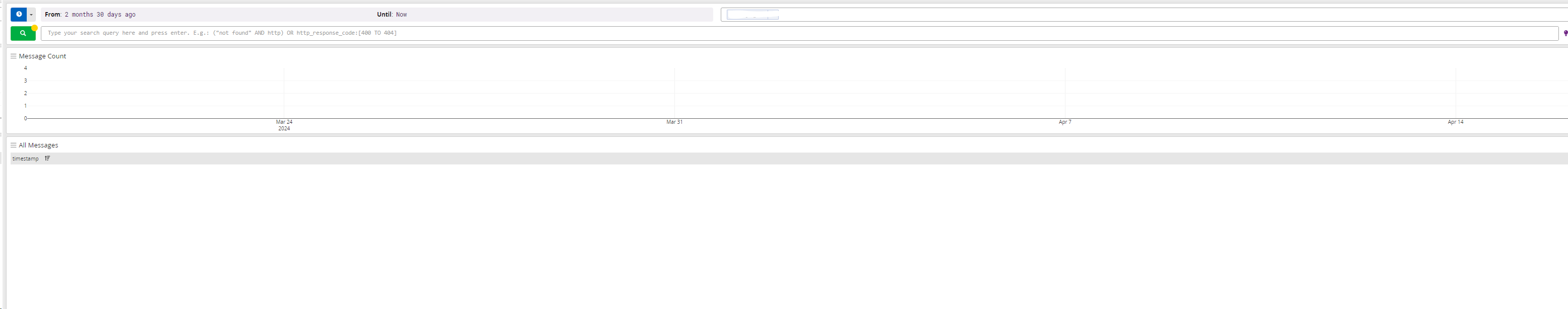

Searches on that stream that has the indexset backed up with the indexes where the information was inserted, there is information from less than a month ago, searching through the console I see the ones but in graylog they are not seen

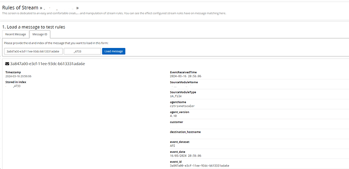

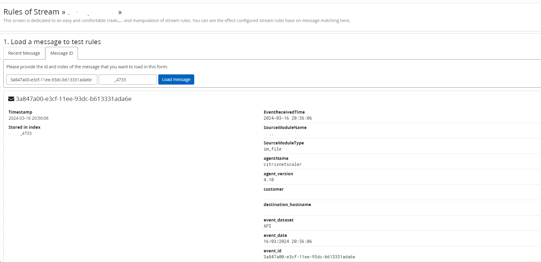

Hello again, as you can see Graylog can see the messages, they are in the elastic managed by graylog, but it does not load them unless it looks for a specific message id, is there a way for it to read everything?
