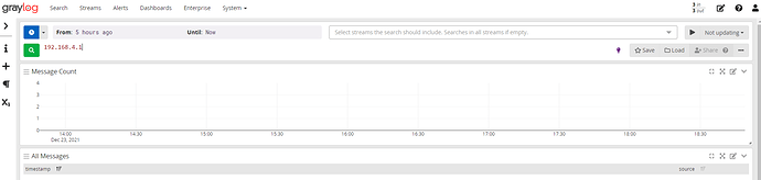

tcpdump shows that the server gets messages but they dont seem to get parsed:
Input setting below:
UDP Syslog Input Syslog UDP
RUNNING
On node 72209db4 / graylog
  • allow_override_date:
true
  • bind_address:
192.168.1.11
  • expand_structured_data:
false
  • force_rdns:
false
  • number_worker_threads:
4
  • override_source:
  • port:
1514
  • recv_buffer_size:
262144
  • store_full_message:
true
Thanks,
myky

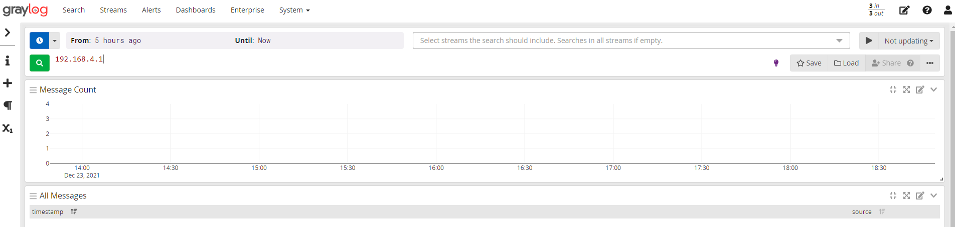

False-positive, guys.
Logs are now displayed:
logs
It took some time tho
Nice, Could you explain how you resolved this?
Hey @gsmith
I haven’t done anything tbh, eventually, I could see all logs in the dashboard after some time (I had a fresh install).
