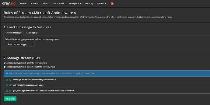

Hello @SalC Welcome back.
So I had this configured awhile back , I believe your talking about Microsoft Antimalware?
Example:
I didnt use a powershell script, tbh im cureiuous on the script your using. Is it posible to show your PS?
