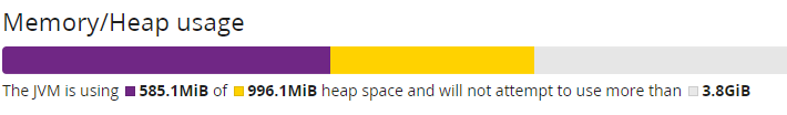

Checked overall status of the installation, doesn’t seem to be missing any ressources.
